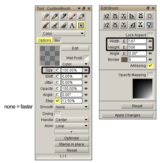

There are several ways to change the size of a brush, which one do you use ?
Welcome in the TVP community !
