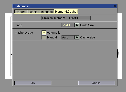

TVP on my XP 64 use all 5 gb! I see it in Preferences/Memory&Cahe. I realy feel different. So, TVP 9 can use the same RAM like TVP 8 on MAC, no more?

Waldek wrote:TVP on my XP 64 use all 5 gb! I see it in Preferences/Memory&Cahe. I realy feel different. So, TVP 9 can use the same RAM like TVP 8 on MAC, no more?
TVP9 *CAN'T* use 5 Gb of memory on win, because TVP9 is a 32 bit app, so it is *absolutely impossible* for it to use more than 4Gb, but winxp restrict this even more to a bit more than 3 Gb.
On MacOSX, TVP9 will use a max of 2Gb *for the cache*, and up to another 2Gb for all other memory needed (and there are a lot of temp buffers for storing intermediate images !).

Win XP 64 and 8 GB RAM, TVP 8 see and use all!

Waldek wrote:Win XP 64 and 8 GB RAM, TVP 8 see and use all!
It's a bug, don't use more than 1.5GB for the cache.
