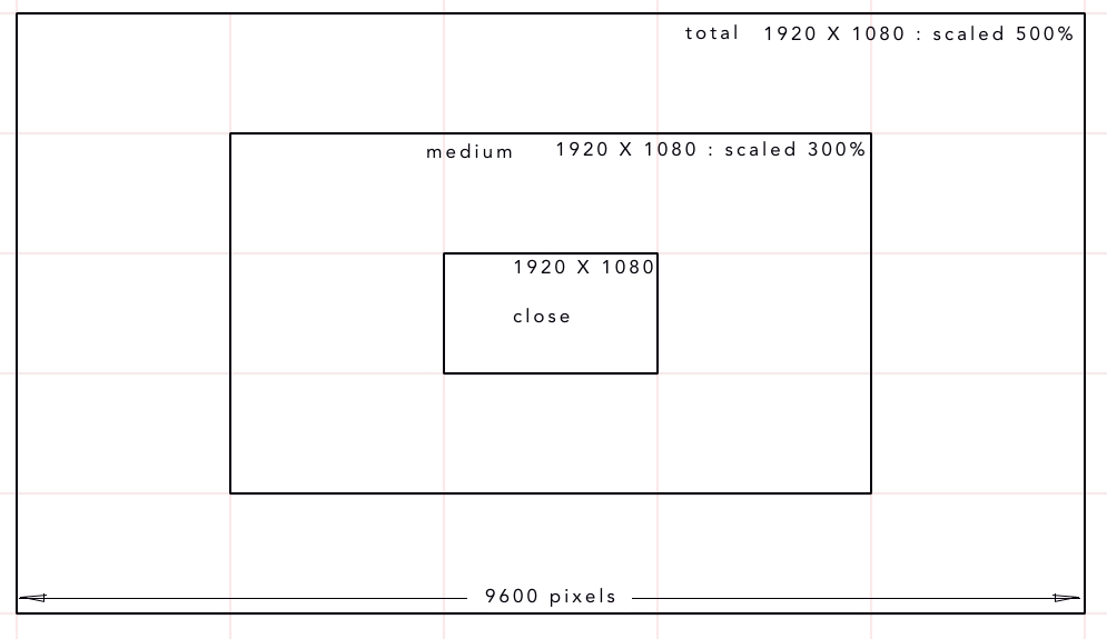

An inventive workaround for this (that Eric clued me into)is to split up the image you want to zoom in on into a number of images of the same size each representing a fase of the zoom(in the example image they are 1920x1280)
and then stack them on top of each other in the multiplane camera (make sure to put them all on the same z-depth but still have the smaller ones showing in front of the bigger ones) each image should be scaled to fit in the previous.
it takes some fiddeling and calculating (well... maybe quite a lot) but once you have set it up you can theoraticly make a zoom without any pixelsize limits without straining your system resources!

I think about Peter`s solution - for future situations. I am not sure if it is working, because I can imagine, that there will be some trouble with different line thicknesses.
Did anybody testet this workaround? I think it`s just a theoretical solution, because I also cannot imagine how I can draw the different pictures so, that they will fit perfectly while zooming. Maybe I am wrong.

Re: Resizing Project to very high resolution fails.
I found that I can rig a multiplane setup before I even start drawing, just with empty layers. This works for normal multiplane stuff with planes with different Z, but identical % settings. It doesn't work for setups with different % settings.

for fun indefinate zooming check this out:Animark wrote: I think about Peter`s solution - for future situations. I am not sure if it is working, because I can imagine, that there will be some trouble with different line thicknesses.
http://www.zoomquilt.org/
you can see some issue with linethickness/sharpness but they do fit perfectly.
This gimmick also demonstrates the limit of zooms, they cannot replace camera movement because the perspective remains static.
To really get a sense of motion the perspective of the different elements should be constantly changing.
