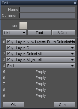

meslin wrote:Is there a way to turn a sequence back into a layers?
yes, create a new button and set Keystroke :
Code: Select all
Layer: New Layers From Selected Image
then, if needed, you can add other commands (see pict.) to align all at left.
at first, you have to select your range of frames, then, just hit the button.
