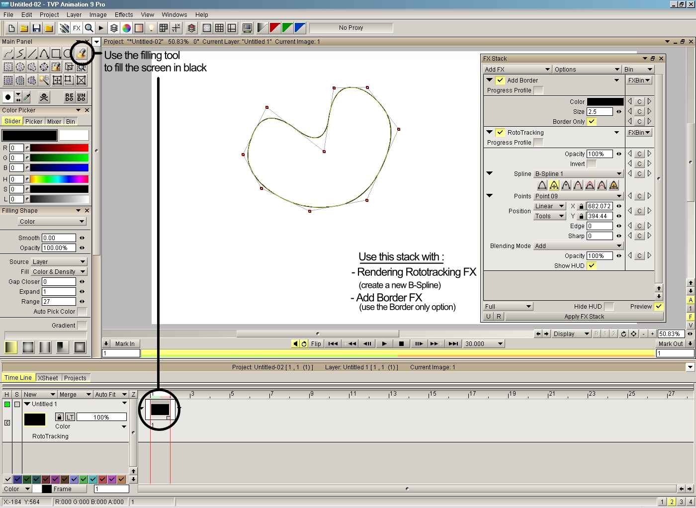

Some asked me : how to animate B-Splines in TVP Animation ?
Here is the answer, I hope it will help.
How to animate B-Splines
Re: How to animate B-Splines
Yes, that' s a foxy workaround, notice also that your (black) color to fill the screen with at the first step
could be orange, green, purple ... or any else color.

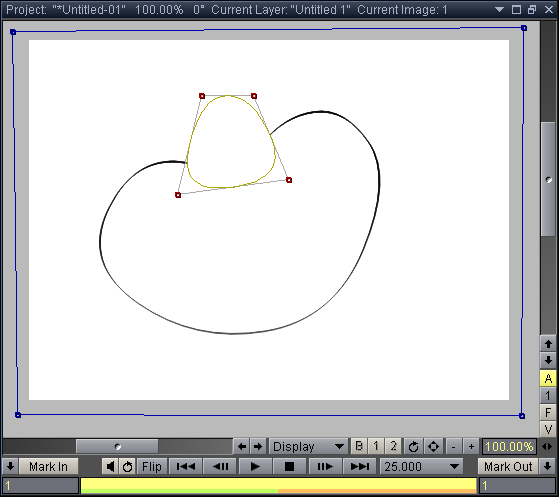

But I would like to have an "un-closed" Spline interpolation tool as well,
actually, animating an opened spline by following your workaround requires to stack
an extra rototracking FX to cut (animate) the "hole".
... and much more FXs to stack if we are planning to "simulate" a thickness variation of the animated stroke.
