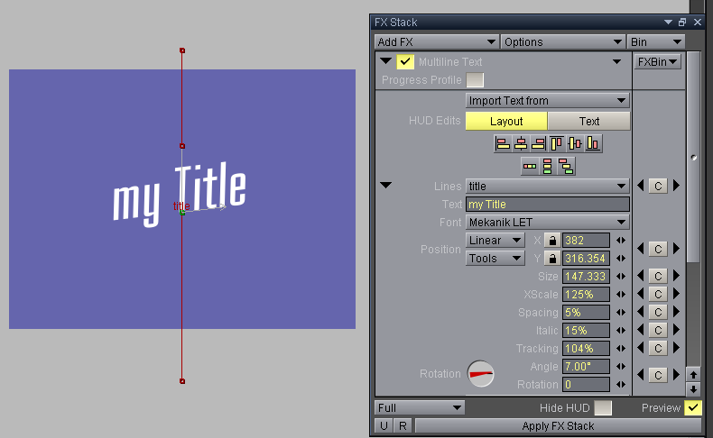

Simple Text_FX or MultiLine Text_FX,ingie01 wrote:... I want to put a title scroll over an animated bkg.
just type/set your title, then create 2 keys, select Frames from Keys and Apply.
notice also you can copy/paste a text from your clipboard.
MultiLine Text_FX still needs some improvement to be really competitive,
such as the ability to edit/modify text settings on a bunch of lines in once.

By God, this is the first time I see this FX!! My eyes always drop straight down to "Simple Text" and have never rested at this trolley stop.
