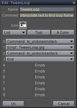

to get rid of the needed multi-undo thing, you may add a tv_undoopenstack command before to copy/paste-append the first frame to the layer's end,
and a tv_undoclosestack "tweenloop" command at the end of the script.
Or alternatively, insert these 2 commands in the Action list of your custom button, (see pict).
like that, a single Undo click will return to the original layer's state. 8)

ZigOtto wrote:to get rid of the needed multi-undo thing, you may add a tv_undoopenstack command before to copy/paste-append the first frame to the layer's end,
Nice tip, thanks Zig. I tried it in the script and, yes, only one undo is now necessary. :D
