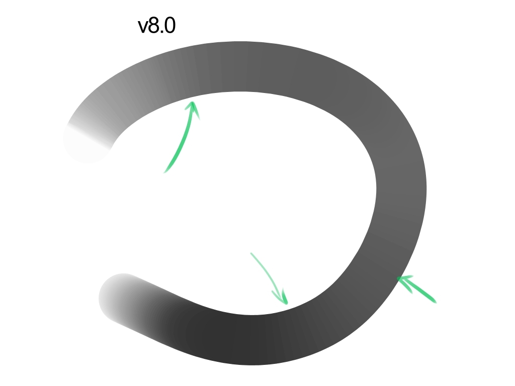

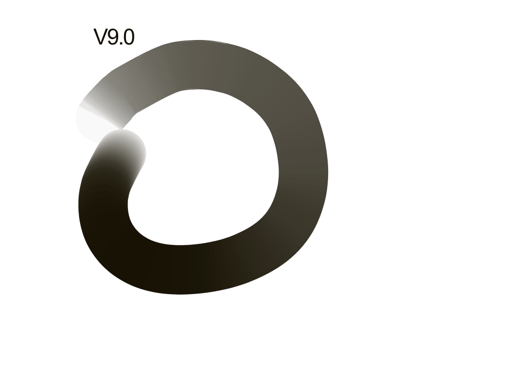

As I said, the pentool has been improved regarding the pressure (see below: you should see more "opacity steps" in the v8.0 and less in the v9.0)Boomslang wrote:Thanks Herve, The watercolor-esque new options are very nice.
I was asking specifically about the pentool, it just seems a lot more responsive and free-er. Hard to put my finger on it. Did anyone else experience this?
Also, the responsivity has been improved too when drawing a curve.
- penbrush_80.jpg (69.6 KiB) Viewed 22651 times
- penbrush_90.jpg (59.3 KiB) Viewed 22652 times
