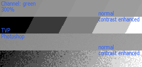

Just did a little test. The first image is a 10% reduction of an 1920 x 1080 image with a very flat gradient (#3366ff to #3399ff) from top left to bottom right. I did it once in Photoshop CS3 and once in TVP, using the exact same colours.
The second image is an enlargement of a detail, showing only one channel, once normal values, once with enhanced contrast to make the difference visible. You'll notice that (at least the new version of) Photoshop already does a stochastic spread of values. This is nice to know (I just learnt it). TVP does the gradient the easier way, just spreading values uniformly over distance, which results in banding.
I don't say that this banding must be visible on screen - this largely depends on how the conversion from TVP rendered images to DCP is done. Maybe they already apply some filter? I don't know.
This is why I appreciate a slightly visible texture so much: it will nearly always cover banding. If I use large gradients, like sky, I think I will do them in PS and import to TVP. All my other colour areas will have some structure in it.

Slowtiger, this excact topic (with almost identical image) was just recently discussed in the Betaforum.
Check out your Gradient panel, it has a 'spread' option,if you set it to 2% and you have you PS gradient.
oh...and the 2% spread will become the new default 8)

Tantalus: Good news! I figured it couldn't be such a big deal to incorporate this. (BTW Photoshop sneaked this in over the last versions. They also changed their airbrush to the same effect. This is kind of a full circle: the drawing tools in v4 acted very "painterly", then from v5 on in went worse, with now being in v10 they try to be "organic" again ...)
