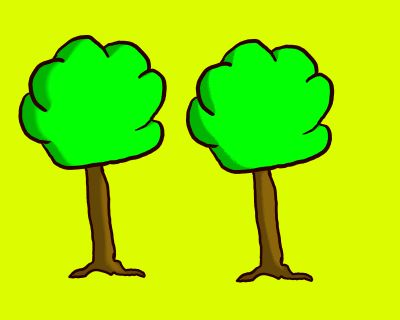

the examples show the kind of effect you can exactly get with the Toon Shading FX.
just play around with the parameters. The profile editor makes the whole difference between qualities of shades.
these ones I made to your tree with Toon shading. I think it's quite similar to what you were doing with the offset blur.
(copyright infringement
before you apply, duplicate the layer that you want to shade, and select the top layer of the two.
Once you go into the Toon Shading dialogue panel tick the "shadow only" box, and this will draw only the shadow, which (after you hit "Apply") will result in one layer for the drawing, and another layer for the shadow. In this way you can control the opacity of the shadow layer, change its color, apply blur etc.
as well, it's always a good idea to keep your color on separate layer than your outline.

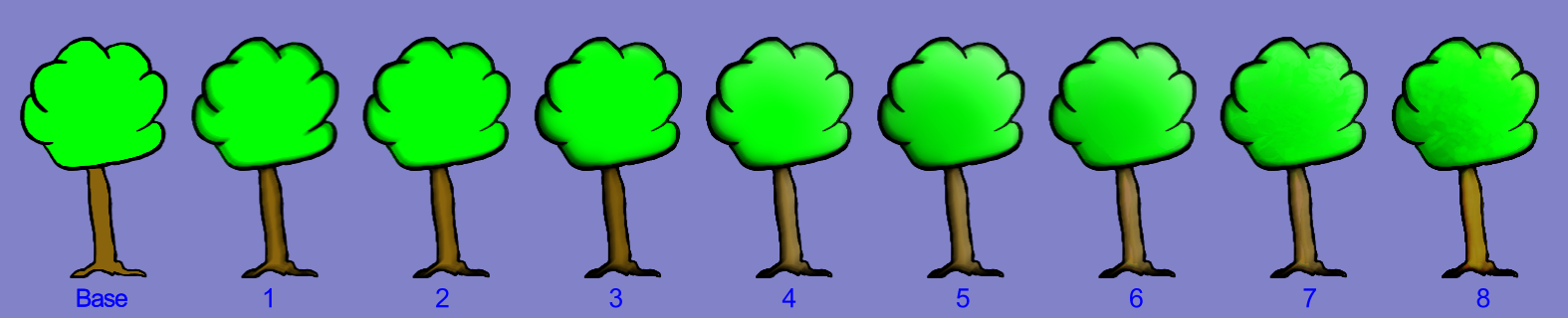

here's a quick attempt to "render" your tree exemple, starting from a flat filled (base) tree * :
-1- dupl. the line layer + directional-blur_FX (color layer as stencil) = "LineShad-1"
-2- dupl. color layer + cubic-blur_FX + Alpha-Control + X,Y offset as new (invert)stencil, then Erase "LineShad-1",
-3- add on the Color Layer a little ToonShading-FX (color = black),
-4- idem but inversed direction and color = white ( or "ToonLighting"),
-5- add a Bump_FX, the color Layer itself as source,
-6- lock Alpha and add a smooth Displacement-Mapping_FX (source = Paper) + Posterize_FX (7 colors)
through the Stencil of 2)
-7- Custom Paper ON, erase the stencil layer and merge it in Color mode,
-8- merge all (except the original outline layer), and add a Color-Sliders_FX to enhance the color rendering.
one FXs assortment amongst millions others,
and it could be applied (step by step) on any still or animated layer,
also, keeping the trunk separated from the foliage could be helpful
to apply on it a different stack (angle, value, bump amount, ...),
of course, starting with a more "textured" color layer,
or filled with custom gradients could give better result as well .
the other way consists to paint by hand your light and shadow,
or to animate (via rotospline) the light and shadow areas, (separated layers),
a lot of work, but much more accurate and controllable, specially with intricate shapes.
