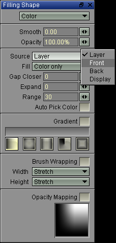

Yes David, you already have all that needed, and even more ...oyonawa wrote:... This way you could keep a layer for the outline and the filled color in a layer below.
Is this option available in TVPaint Pro??
Clone you "line" anim-layer with the [Cl] button of the Instance panel,
so, you will get the same animlayer (same timing), but with empty cells,
then, on this new layer, the one reserved to colors, use the FloodFill tool,
but after having set the Source to "Front", (FillShape panel, see pict.)
then,hit [>C] = next Cel, Fill, next Cel, Fill, next Cel, Fill, ... etc.
also don't miss the excellent "AutoPick Color" option, very handy with the LightTable !
(see 6-27 in the manual.)
- FillShapeSource.png (18.84 KiB) Viewed 24158 times

OK, seeing this post, I decided to try it. The Cl button clones my layer but the flood fill just fills the entire screen when I use it.???? I must be doing something wrong, I thought I followed your directions exactly.
WinXP 32bit 10.0.17Pro
Re: Flood Fill in layer below
Sierra : the layer with your outlines must be on top of your current layer (Color), if you set the Source to Front.
Manuel
yeap, the Clone Layer button originaly has been created to clean up a rough anim (blue pencil) on a new layer,
so it is placed on top of the original (the "blue" layer),
if you want to use it to create the color animlayer (down the clean outline layer)
you can edit the [Cl] button and remove the line1 Layer: Go Up command.
otherwise, you can color on a layer over the outline layer, but select "Back" as source,
when finished, just drag up the line layer above the color one.
