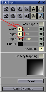

in the Edit Brush panel, keep Lock Aspect Off, and click (enlight) one of the Width, Height [E] gadgets,
then, in the project window, your custom-brush should be sticked at the right_bottom corner of the cursor,
(HUD) click&drag this corner to resize unproportionally, the up-left corner being the pined.
- BrshResize.png (14.2 KiB) Viewed 24142 times

Re: Scale unproportionally
I miss the unlocked proportional resizing of the cutbrush too. I used it often in Mirage. Is it called something else in TVP or is it not available?
Sven
Sven
It still exists, but afaik only via the Edit Brush panel.Svengali wrote:I miss the unlocked proportional resizing of the cutbrush too. I used it often in Mirage. Is it called something else in TVP or is it not available?
Sven
the "Brush Resize" command in the shortCut right-list is a proportionnaly Resize,
you're right, we definitively need a "Brush Free-Resize" shortcut.
i'm on tvp 8.6.2 and in mirage i too always use the z key, keeping 'lock aspect' off in the edit panel for quick use scaling unproportionally.
is my only option in this version of tvp to
1)go to 'edit brush'
2) enlighten the 'width/height'
3) apply
every time?
obviously i'd rather not pay hundreds of more dollars for an upgrade right now.
3) apply
every time?
Hi Charlie
The free resize option is only available in the V9 ( brush: Free Resize )
But you can use the + - keys to resize proportionally and the z key to resize unproportionally.
