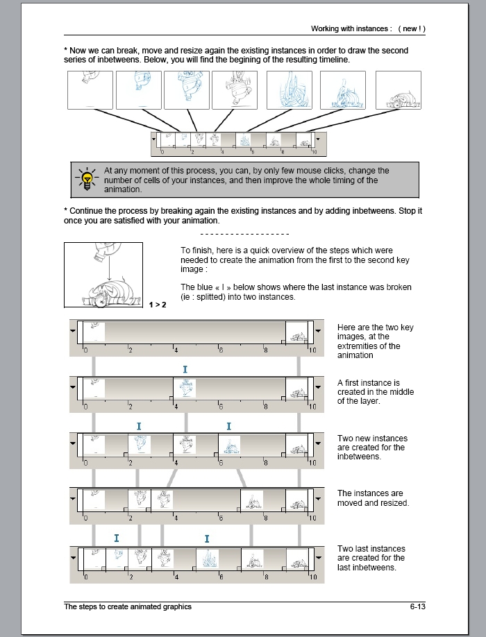

Hi Paul,
Could you check this : (user manual lesson 6-13)
Adding or removing an exposure allows to work on the timing of the animation without having to add empty frames.

Thanks, Fabrice, now I understand. I've worked this way for many years now and just somehow slipped into it without giving too much thought to iy or analyzing the steps I take from intuition. I am just getting used to taking advantage of the stretching out of individual frames (creating holds by dragging out frames) and realize how there is more to it than meets the eye.
When I was in Amsterdam recently and had met up with Peter Wassink and his friends they told me about this while they had trouble explaining to me why it's such a big deal, compared to just repeating instances or taking them off, frame by frame. Now I would have trouble too if I had to explain to someone why this adds more to the process than just eliminating the clicking on a keyboard.
So what Herve suggests, which is to make the exposures (something already there) expandable by a selected number of frames would be very useful for creating animatics, which I happen to work with a lot (having for the most part dropped the need for storyboarding). Fascinating stuff.

actually, it's the "Set Frame Repeat" command.Paul Fierlinger wrote:... to make the exposures (something already there) expandable by a selected number of frames would be very useful for creating animatics, which I happen to work with a lot ...
(need to be added as button in the Instance Panel)

Herve, I've studied up on instances now (I had the manual printed and bound at Kinko's) and now that I know the difference between exposures, images and empty frames from a few test runs I'd like to ask you to PLEASE NOT make the tween button create by default exposures instead of empty frames!!! The instance work flow does not work well for me and I am sure I am not the only one who will feel this way.Hervé wrote:Good idea, but it should add exposures in place of empty imagesPaul Fierlinger wrote:Can the excellent Add Tweens button on the Animator Panel be improved by not having an empty frame added to the last frame? It serves no purpose since there is nothing past it to tween between therefore each time it needs to be deleted, if one wants to maintain a hold, which is nearly always the case?
I like to have empty frames between my key frames so that I see them flash by. To have stretched exposures just doesn't simulate the timing for me -- it turns animation into a slide show before I'm finished with it. It makes me look at a single drawing for a longer period of time than I intended when I drew it. To simulate real time playback I prefer to have flashes instead of holds -- a huge difference in perception.
Re: Add Tweens improvement
That's where the instancepanel comes in. The two B's are meant to create new (blank or same) instances within your instance, so if you only want to see your keydrawing for 2 frames and blank cells behind it, it's a matter of pushing a button.
