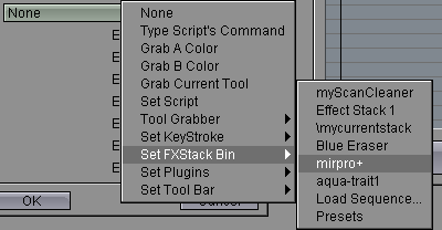

did you carefully read my previous post, Paul ? the answer was there :Paul Fierlinger wrote: I know how to make a new ToolBar and button, but after opening None, where do I go?
RMB edit the button, click on "none" and go to Set FXStack Bin /yourBinFile from the popup list.ZigOtto wrote:... (set FXstack Bin ...)
- SetFXstackBin.png (8.62 KiB) Viewed 23241 times
Here's the problem: I don't have that one line on my list of options. No wonder I was stumped! My trial version says it's TVPaintAnimation Pro 8.5.10 US Feb 27 2008. Perhaps that feature came at a later date?

seriously, I've no idea why you haven't the "Set FX Stack Bin..." command,
this feature came far before the v8.5.10, I am still in v8.5.9 (june 2007) and I have it .
you have to wait for monday morning and ask to one of the tvp guys.

Maybe right there is the explanation. This wouldn't be the first time that I have seen something inadvertently deleted in between new releases. It'd be interesting to hear from anyone who has my version if it's there or not.I am still in v8.5.9 (june 2007) and I have it .
Besides drawing my own camera moves anyway, this is not such a big deal in my work flow. Thanks for taking the trouble though.
