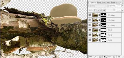

I would like to make a timeline in which a photosequence can have a texture on a part of the immage.
I can't get past the point where using a mask in TVPAP effects all layers, instead of only the layer I want it to be in. Does a function like linked layermasks in Photoshop exist in TVPAP?
The solution I found for now is to make two different layermasks in Photoshop for each frame. But I wondered whether there is a quicker way to do this in TVPAP?
To illustrate what I am writing about I show you a screendump of a sketch...
Thanks for answering, regards, Conny

a bit further into masks and stencils
Maybe the preserve alpha option is enough for your needs ?[/quote]
Thanks for pointing out this option, but it doesn't do quite show what I want to see in this case. Although it will make the workflow of some other idea's easier. (And I will keep the refresh of the stencil-layer in mind.)
I was trying to to create a stop-motion photographed tree with an animated semi-transparant skin of silver.
For any-one who is interested in this too, I dug a bit further into the masking-parade and found a solution:
-made 2 layermasks in photoshop to cut out the tree and the skin of the tree
-loaded the photoshopdocument as different layers.
-then joined the tree-layers as well as the skin-layers into an animationlayer.
-duplicated the skin-animationlayer in order to use the top-one as an animated mask and fill the second one with an animated brush of silver, using "source" out of the FXStack.
Hope I don't see this much more complicated then it needs to be - but the result looks beautifull
NB: I don't think there is a significant difference in painting layermask in Photoshops or painting a masked animation in TVP, but I simply work faster and more precise in making layermasks.

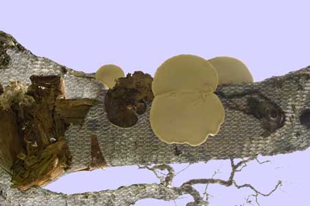

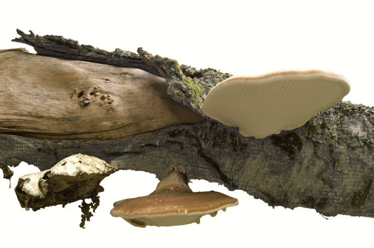

screendumps on using masks
Hi Fabrice,
Sure, no problem, here they are:
