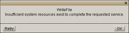

We're having a strange problem with current (8.5.7) version of tvpaint on pc. When I press compute in preview settings window I get these two popups (see attached images).
I guess this has something to do with temp folder. Current setting is f:\tvpaint. I've tried various other folders on different drive too but with no success. Temp directories were made by current user so I guess it's not about file permissoins.
I noticed that tvpaint adds / (which will not work in windows) in the end of the temp directory settings in preferences window. Could it be what causes this problem? I also viewed the configuration file (C:\Documents and Settings\[user]\Application Data\tvpaint animation pro\default\config.ini) and it said only f:\tvpaint (with no \ or / in the end. I tried adding \).
And about the workstation (I know you'll ask this). It's Q6600 with 4GB ram and nvidia gforce 8800gtx. Operating system is windows xp 64 with all the latest updates. Nvidia drivers are also curret version.
Thanks for help in advance :)

But what if I have set proxy in preview settings? If tvpaint is unable to write into temp directory (the second screenshot), the proxy setting is pretty much useless?

sakari wrote:But what if I have set proxy in preview settings? If tvpaint is unable to write into temp directory (the second screenshot), the proxy setting is pretty much useless?
your tvpaint reported insufficient system resources, which I assume that it refers to disk space. According to the bug the report about disk speed is very high, so it tries to write a lot of information to the hard drive according to that calculation: 1638 MB for each second of your animation. If you reduce it to some reasonable rate, the calculation might find that there is enough space to write to the drive. This affects Realtime, proxy and render modes all together.

malcooning wrote: your tvpaint reported insufficient system resources, which I assume that it refers to disk space. According to the bug the report about disk speed is very high, so it tries to write a lot of information to the hard drive according to that calculation: 1638 MB for each second of your animation. If you reduce it to some reasonable rate, the calculation might find that there is enough space to write to the drive. This affects Realtime, proxy and render modes all together.
Give it a try.
It's not about insufficient system resources. The disk I'm using as a scratch disk is a empty 146GB drive. I'd like to see a hard drive or hard drive controller that could fill 146GB hard drive in a blink of an eye ;)
Isn't the compute function there to tvpaint to find out how fast disk you have? It doesn't matter if I put 1 or 1000 there, tvpaint sets it to what ever it thinks your disk speed is after a successful testing.

Of course it does. It's not about the value. I don't care if the computation gave me number 2^22222222.
I'd like to know if the problem is only in preview settings. What if the problem is system wide and tvpaint is, because of it, unable to use temporary directory at all?
That would probably affect in tvpaint's performance!
