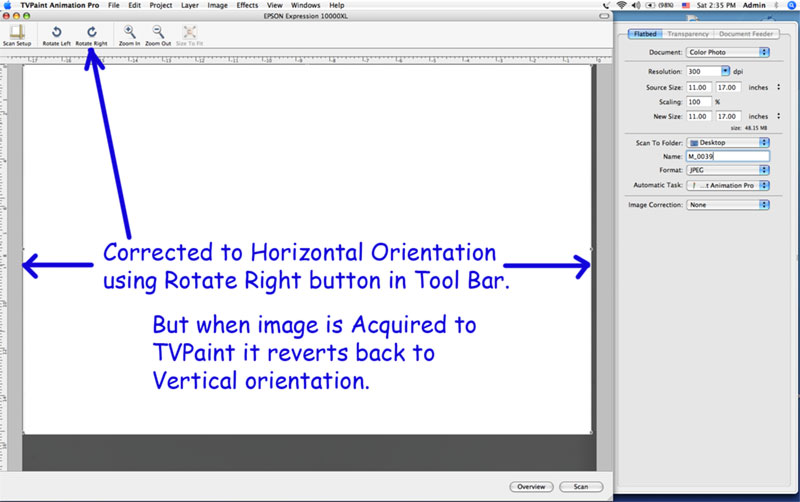

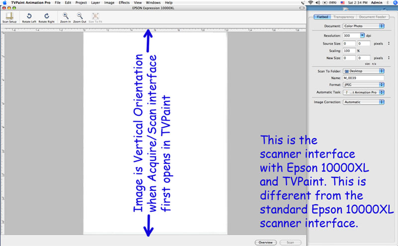

I am attempting to scan some hand-drawn animation drawings into TVPaint.
I can not get the orientation of the image correct (horizontal orientation of the image , with peg holes along the bottom edge) .
I am on Mac Intel, Mac OS 10.4.10 , using Epson Expression 10000XL scanner .
Here is what I do :
1.) Choose ICA --- Acquire ----Append to Current Layer.
2.) When the scanner interface window opens up the orientation of the drawing is vertical (see attached screen grabs) , so I need to change it to horizontal orientation.
I use Rotate Left from the toolbar of the scanner interface window and the drawing is rotated to the correct orientation.
3.) I set the marquee around the drawing so it will scan the entire image , including the peg holes . (11.97" x 16.97")
Then I click on Scan.
BUT ...
4.) When the image appears in TVPaint the orientation has reverted back to vertical .
How do I make it appear with the orientation that was selected in the scanner interface window ?

weird, I never had this problem, I use to set the scan orientation by the little [F] gadget (see .gif below, Rotate clockwise 90°), and the exported file come as expected (the preview stay unchanged) ...
OK, it's not an epson, and I am not on Mac, but TVPA seems to respect what the user set within the scanner driver.
looking at your grabs, it looks like you have rotated the scan Preview,
not the Output datas (otherwise W & H sizes should be inverted, no?)

That's the only option I have within the scanner interface for rotating ... I don't have the little "F" orientation box that you mention in your post above.ZigOtto wrote:
Maybe I need to go in to the Epson Scan settings first and make some sort of adjustment . Odd thing is that I use the same Epson scanner to scan art to Digicel and ToonBoom and when I use those apps they see the scanner orientation as the proper horizontal orientation (with pegs along the bottom edge ) .

Thanks for investigating, EM .ematecki wrote:I'm investigating !
I guess they use a non-standard but often used by digital camera tag for rotation in the image data.
I'll keep you informed.
EM.

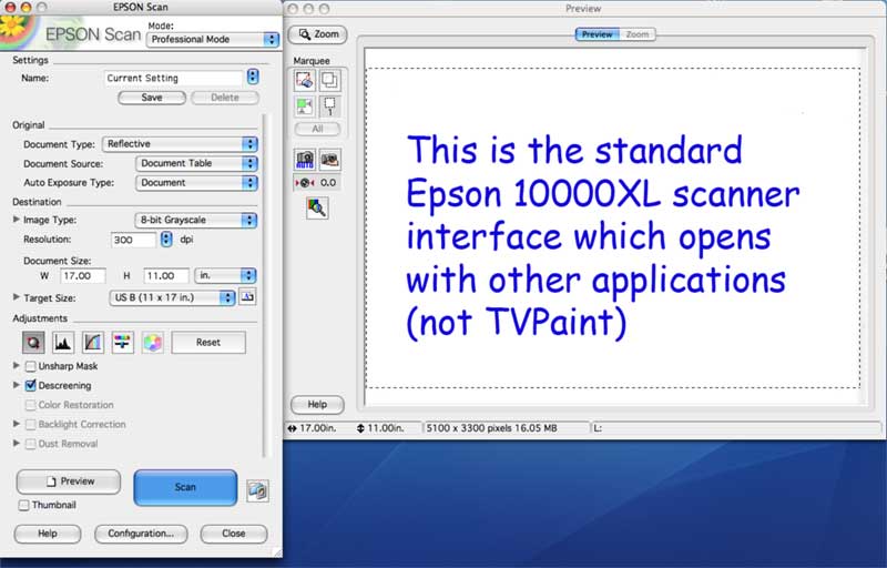

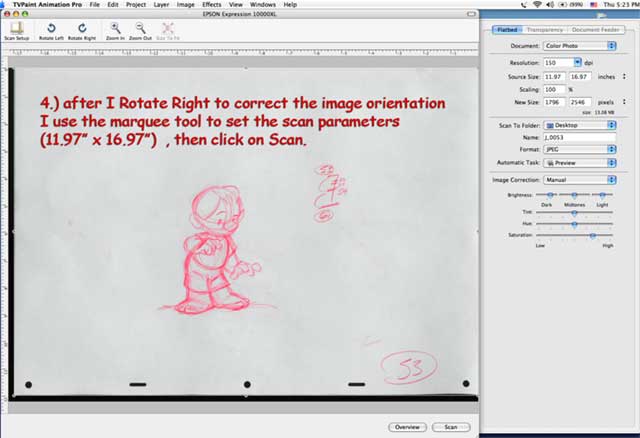

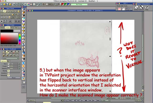

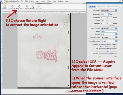

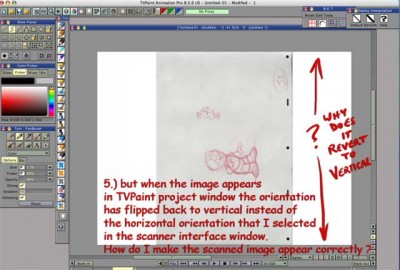

To review see the attached screen grabs using TVPaint to Acquire from Epson 10000XL scanner.
1.) I choose TVPaint File menu --- ICA --- Acquire--- Append to Current Layer . (no screen grab for this)
2.) The scanner interface which opens is different than the standard Epson 10000XL interface and the image is on Vertical orientation. (see screen grab below)
3.) the only available tools for rotating the image orientation are Rotate Left and Rotate Right in the toolbar.
I rotate the image Right to correct the image orientation to Horizontal. Then I click on Scan button, but when it appears in TVPaint the image has reverted back to Vertical orientation.
4.) I'm including a screen grab of the usual Epson 10000XL scanner interface that comes up for use with other applications (other than TVPaint) .
OK, here is a work around until it is fixed in the next update.
In the "Format" popup in the 'drawer' select PNG instead of jpeg.
In any case you shouldn't use jpeg, because the scanner (or more probably the driver) sends jpeg data in this case, which is a lossy compression and you loses some of your data !
As strange at it sounds, the scanner uses the selected file format even if not saving to a file !
DON'T use jpeg if you scan from inside an application !
Eric M.

Thanks, Eric. That did work to use PNG format . The scan kept the corrected horizontal orientation when it opened in TVPaint.ematecki wrote:OK, here is a work around until it is fixed in the next update.
