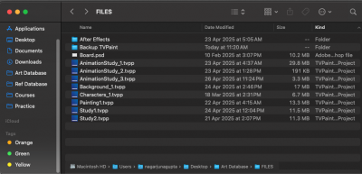

A common source of difficulties is using external volumes for Autosave as well as normal save. Could you check these first?

slowtiger wrote: 30 Apr 2025, 07:46 A common source of difficulties is using external volumes for Autosave as well as normal save. Could you check these first?
Hii, I don't use external/ multiple volumes.
