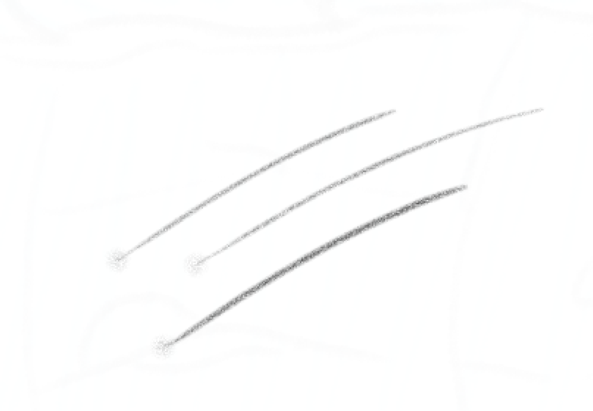

I recently encountered an issue with tv paint 11.7.5 on my windows pc using a Cintiq 24 HD. When I use the pencil tool, the start of the line will have a feint dot at the start of the line as if its at 100% pressure. I have tried uninstalling and reinstalling my wacom drivers and it did not seem to work. Is there any solution to this issue?
Screenshot 2025-04-24 230645.png (63.28 KiB) Viewed 7474 times

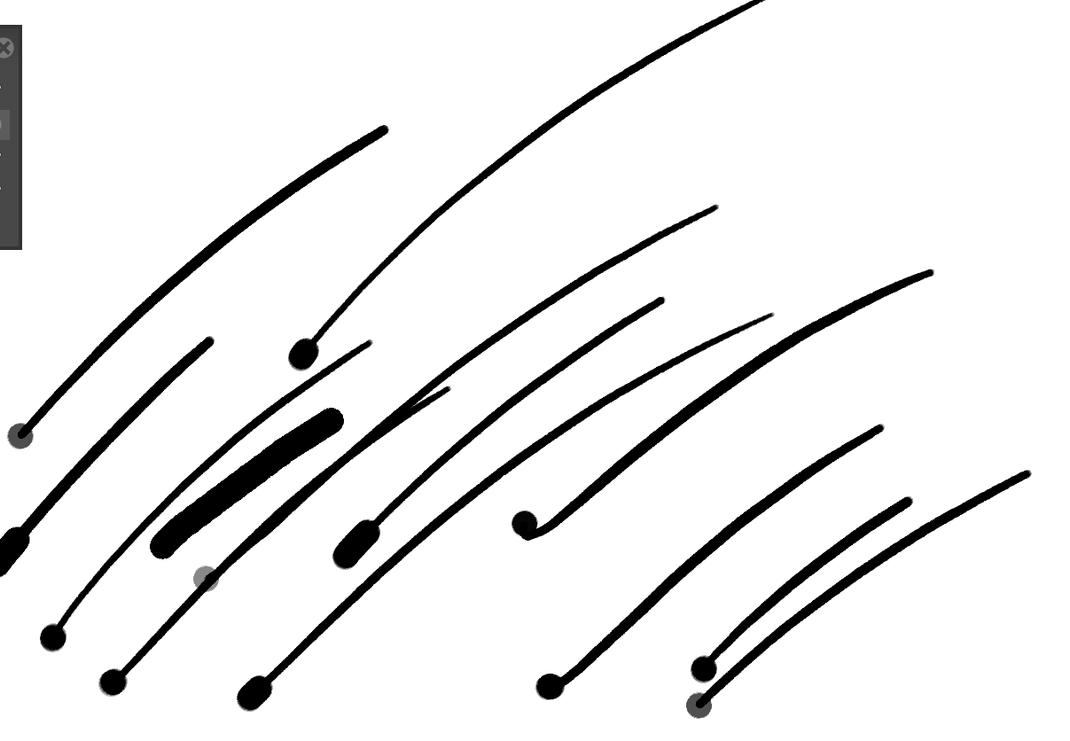

I have tried reinstalling and reinstalling both my tablet drivers and TVpaint but the issue persists. The only time there is no issue is when I disable my tour box device/ shortcut remote. I am not sure why but my remote is interfering somehow. Does anyone know a fix?
Screenshot 2025-04-25 021729.png (80.78 KiB) Viewed 7415 times

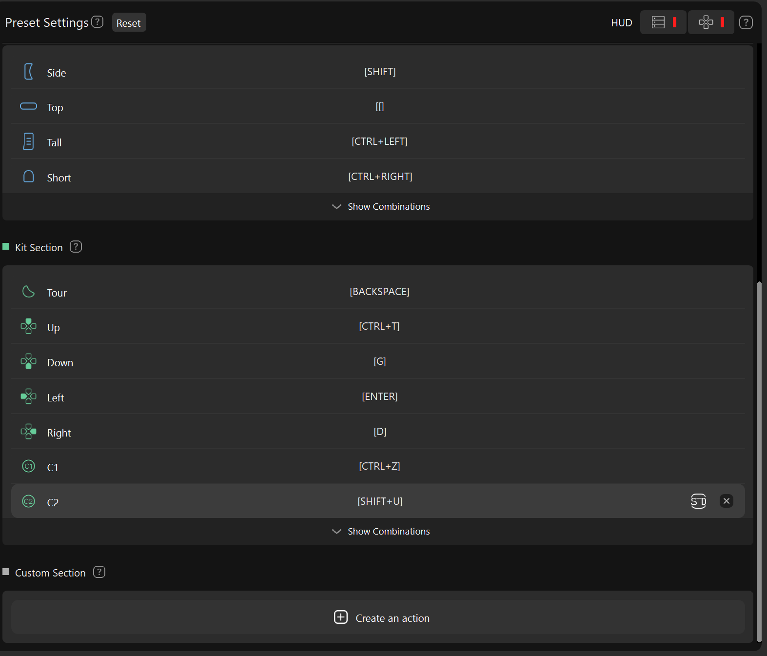

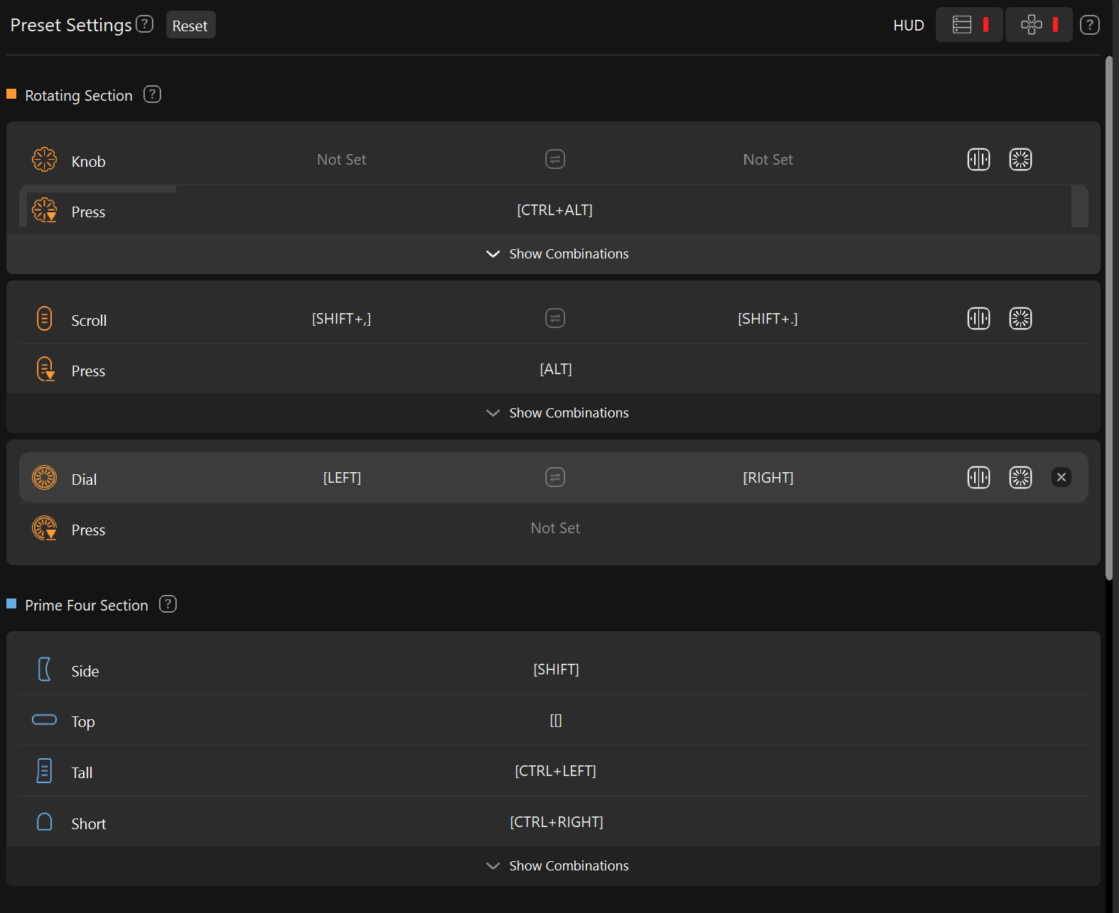

Dean wrote: 25 Apr 2025, 11:19 Hello Akira, did the issue appear overnight? Some setting change in your remote could be conflicting with TVPaint, which TVP shortcuts did you bind it to, please?
This is a list of shortcuts assigned to my remote. None of them are related to pen width or line pressure so I am not sure why they would cause an issue.
Screenshot 2025-04-25 142402.png (63.15 KiB) Viewed 7266 times
Screenshot 2025-04-25 142422.png (73.98 KiB) Viewed 7266 times
