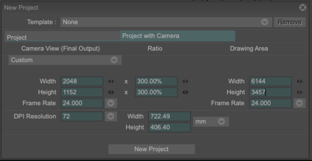

As Thierry mentioned, this is easier to manage in vector programs such as Harmony so I don't think we will see this in the current TVPaint engine , but hopefully in a future version. (although raster programs like Photoshop and others allow for drawing information that is outside of the main work canvas to be retained, so if you shift a layer up or down or side to side , the pixels that were drawn on that layer are not lost , but can still be seen if the layers are shifted again. As it is now, TVPaint crops and deletes information on anything moved outside the main canvas area, so if you move it back in to the main canvas area the image is cut-off. I would be very happy if TVPaint could at least have this function, as in Photoshop).Nagarjuna Gupta wrote: ↑03 Apr 2025, 17:40 2. Extended Canvas, one thing that I really find cool in Toon Boom is that they have this Illustrator style canvas where you can draw beyond the Artboard/ frame. This would be really awesome if we can have it here, very helpful in pre-production stages. It could also be a DRAWING PLANE GUIDELINE where we can draw on and move around, rather than having an infinite board. This could reduce the taxation on hardware as well.
The workaround that some of us use is to start a NewProject using the Project with Camera and make it 200% - 500% larger than the intended output area , so for example if your intended output is 2048 x 1152 , you could make the project 300% larger (6144 x 3456) , so when the new project is generated you have a sizable border area outside of the camera view, which is where you will draw your animation. If you don't need that much border area make the project only 200% or 150% .
All animation is drawn within the 2048 x 1152 window (camera view), but you have the rest of the canvas to use
for drawing, notes, reference images.
Of course this also makes it easy to do extended camera moves, because you can
draw out your images to extend beyond the border of the 2048 x 1152 camera view and then allow the camera to roam freely
across this extended canvas. In the end you are outputting to a video file that is sized at 2048 x 1152 or 1920 x 1080 .
The disadvantage is this oversized canvas will make the file size larger. (not much of a problem if your computer is fast and you have plenty of RAM)
