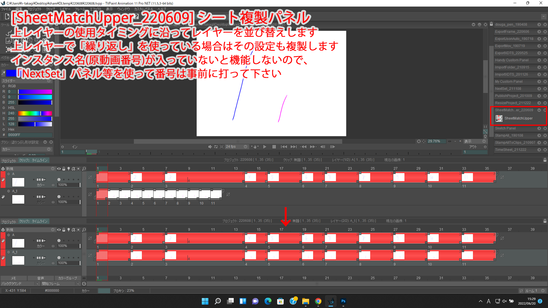

I have previously distributed a panel like the one below at a Japanese user forum.
・SheetMatchUpper
I'm sorry that the explanation is in Japanese, but I think you can get the meaning from just the images.
SheetMatchUpper_220609.tvpx
