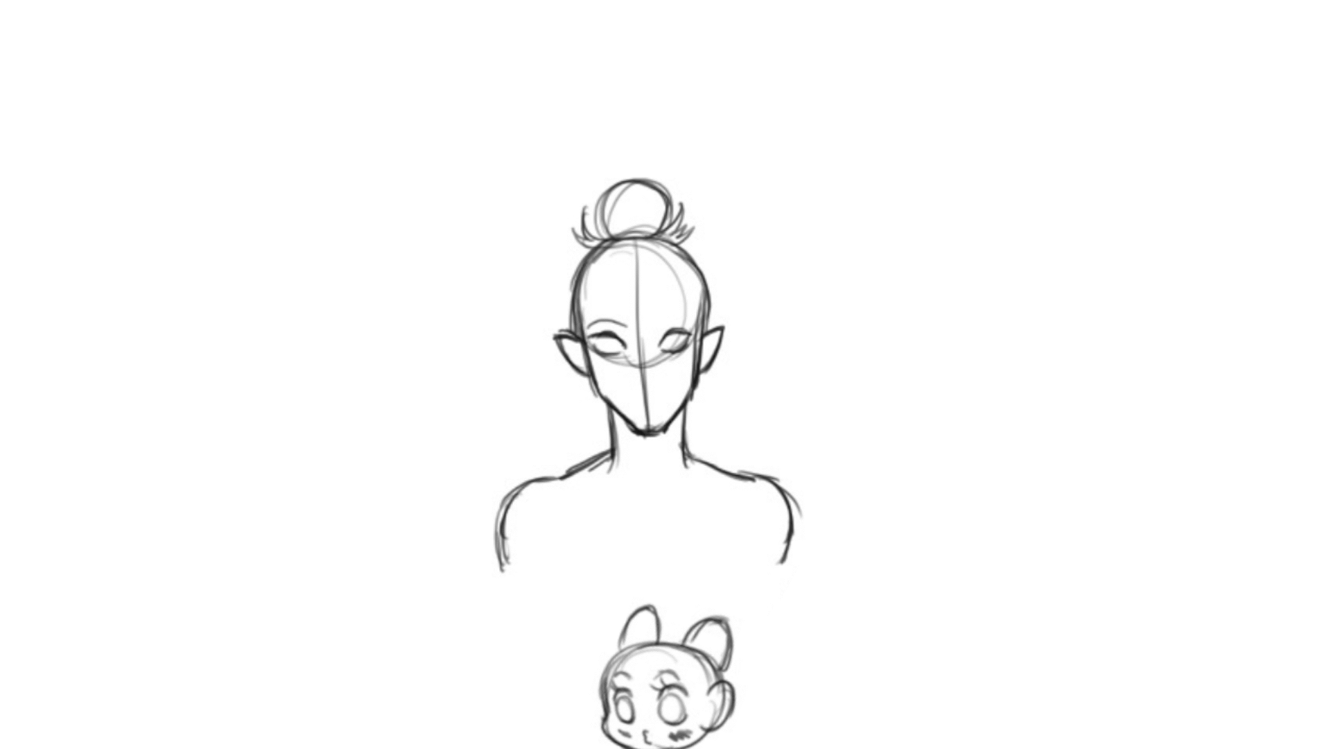

HELLO!
TV Paint NOVICE HERE! Complete newb!
Okay I feel like I may have to do this in AE but I'm curious can I make these chibi heads rotate around this guy in the center in TVP?
Or is this something I will have to figure out in After Effects?
The idea is to make the chibi heads rotate like a Ferris wheel.

I'd create a layer with the curve I want the heads to follow as a guide, indicate the frames on it, set it to hold. On top of that I'd move each head frame by frame with the paning tool.

Here is how I would do it .
The central head is on a separate layer.
On another layer use a circle guideline around the central head (use the Circle tool in the main panel)
On a third layer arrange the other heads so they are centered on the circle guideline. (now hide this layer)
Create a new blank layer that is stretched out for the duration of the time you want the "ferris wheel" rotation to take (in my case I chose 48 frames)
Go to FX Stack > Motion > Keyframer. In the Keyframer SOURCE tab set the source to the Ferris Wheel Heads layer.
In the POSITION tab uncheck box Offset/postion and check box Offset/pivot , then move the pivot point so it is centered on the head.
Now go down to Bank > Angle and set the first keyframe to Angle = 0.00 , then go to the last frame and set the keyframe to Angle = 359.00.
*IMPORTANT: now click on that last keyframe and drag it over to one frame beyond the last frame of the animation. (see the attached screenshot and .tvpp file)
Select all frames on the blank layer and with Keyframer set to apply on Frames , click APPLY FX STACK. Now the ferris wheel rotation will be applied.
TVPP file - https://drive.google.com/file/d/1KmsVIl ... sp=sharing
On my example I had to arrange the chibi heads a bit differently than on your original drawing , to make them fit on a circular guideline for the "ferris wheel" rotation effect.
On yours the arrangement of the chibi heads is in an oval pattern , rather than a circle , so the rotation will look odd if it is an oval arrangement of the heads.
The spacing of the chibi heads on mine is still slightly off , could be better , but I am out of time to do anything more on this . However, I think this should explain it sufficiently for you to do what you want to do in TVPaint , without resorting to AE.
If you want it to go faster you can apply the rotation to a shorter duration of frames (in this case 20 frames, instead of 48) and add option Motion Blur in the Keyframe FX.
Or the rotation can be slower if you apply it to a longer duration of frames, say a duration of 60 frames or 72 frames.
(the problem with a faster rotation, even with motion blur, is you can run into strobing and the optical illusion that the heads will sometimes seem to rotate in the opposite direction.)
20 frame duration (faster)-
72 frames duration (slower) -
(and obviously, this can be done as I imagine you are planning it , to have the Chibi heads all animated on cycles of the heads laughing or talking --- and the central character perhaps glancing from side to side at the Chibi heads as they rotate around --- then using the Chibi Heads animation layer as the Source in the KeyFramer you can add the ferris wheel rotation.)

:mrgreen: Fun to see everyone going at this... but you all did not read the "Ferris Wheel" stipulation in the assignement.
A ferris wheel motion means that while the little heads rotate around the center figure head, all the little heads should remain their upright orientation...
now it becomes a bit more tricky.
Still its doable if you counterrotate the individual heads around their own center while they follow a path around the main head.
we run into some limitations of tvpaint. for instance... its not so easy to create a circular motion path. and its impossible to create a perfect circle.
Though you can get close... put a saucer on your wacom and trace its outline with your pen, while recording a motionpath...

I haven't used the keyframer a ton, but I think unless I misunderstand what is being said above that it is feasible to do the ferris wheel effect where the heads stay properly oriented vertically and you can get a nice circle as well (using a guideline/snap to place your keys).
Attached below is a video, sorry for the rush job and hopefully it is clear enough.
1. I cut one of the heads into a custom brush and added to the library, there are other ways around this if you don't have the pro version and the library.
2. Set up a circular guideline(this should work with an elipse but perhaps needing more keys)
3. Used snap on the guideline and set four keys in the keyframer at approximately the 12, 3, 6, and 9 positions(on a clock), and this is a 48 frame loop with the frames at each position set evenly(fr 1, 13, 25, 37, 48) The offset /position set to spline for each of these. Then using the guideline I eyeballed using the bezier handles on the spline to get the red circle(keyframer path) in the video close to the guideline circle(blue circle).
4. The layer has loop set to the end behaviour so it loops.(i realized after recording I had the start frame set to 0, and it is not actually evenly spaced frame wise, but that is just a mistake.)
I don't know how to embed a video, so please click through.
Ferris Wheel Keyframer.mp4
(8.72 MiB) Downloaded 447 times

If you really want to get technical, you need to plan ahead:
Turn field guide visible.
Place each of the little heads (on its own layer) in the center, center should be the pivot around each head spins.
Use Keyframer to spin each head around 1x, in as many frames as one revolution around the big head will take, and in the opposite direction.
Now you have one head rotate layer for each little head.
Use Keyframer again to rotate one head around the big head. Apply to all little head spinning layers.
Shift these layers in time so they space evenly.
