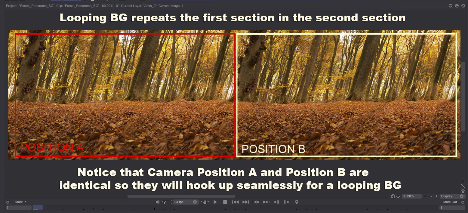

I would start by preparing a wide pan background that has the exact same content on both ends.
(in this case because of the strong vertical shapes of the trees I tilted them slightly and will blur them in TVPaint to
avoid strobing)
(click on the images to see them larger)
So Camera Position A and Camera Position B are identical. This allows for a seamless loop using the KeyFramer.
