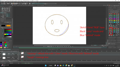

I think what you want to do can be achieved by first drawing an orange rough on the first layer,
then drawing black on the upper layer in mode "Color" and blue in mode "Behind".
The SkewtchPanel RBG that comes pre-installed in TVPaint is designed to do just that.

Re: drawing between 2 colors
In fact you can work on only one layer with the Sketch Panel RGB tools, but you will have only two options : if you draw with the black line above the blue line it will use the Blending Mode in "Color" so above the blue and if you use the Orange line it will draw under all the color beacause it is in Blending Mode "Behind" so behind the other existing pixels.
