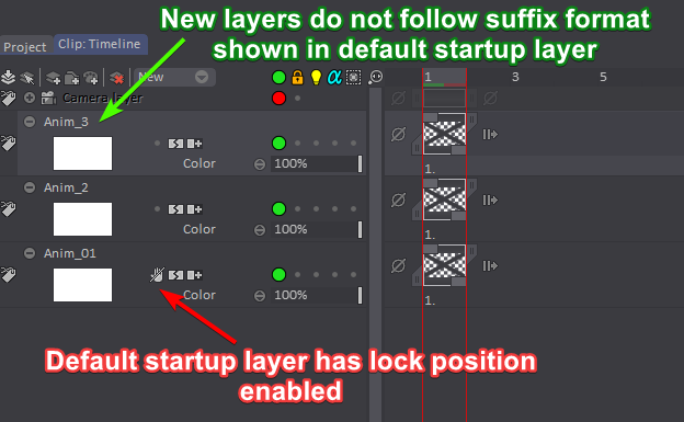

1. When booting up TVPaint, the layer we are first given will have lock position enabled.
If it is a feature I really recommend removing it otherwise I'm treating it as an issue
because the past versions never had this in place.
2. Suffix of new layers do not seem to follow the same format as the initial starting layer
-It is a small nitpick but I wanted to squeeze it in this post.

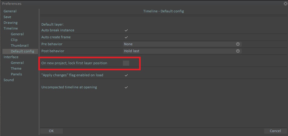

1) It can be disabled.
Preferences Window: Timeline - Default config
TVP12
lock layer on startup.jpg (48.84 KiB) Viewed 8059 times

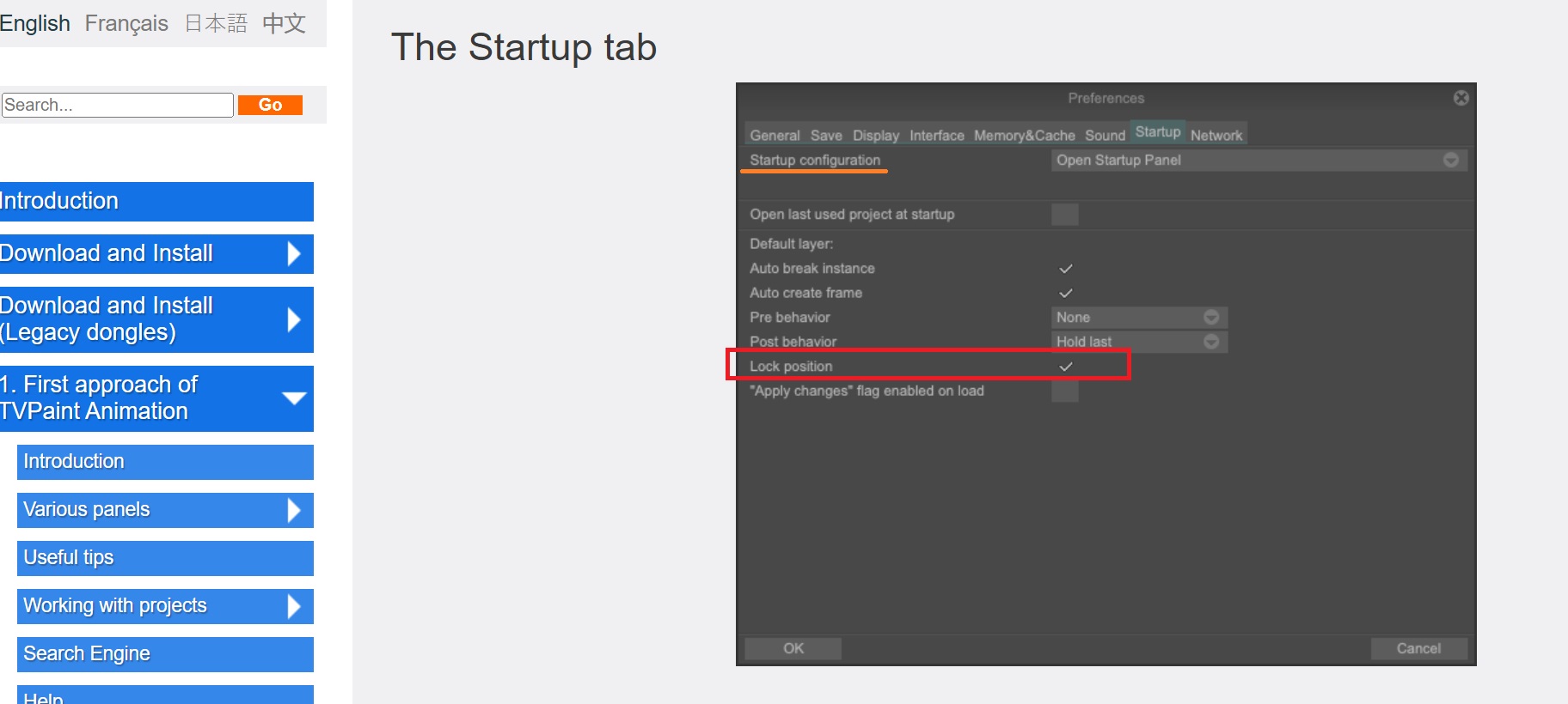

Not sure when exactly it was added in previous versions but it's been in TVP11 for a bit. From the online manual:
TVPaint 12.0.0 Pro
