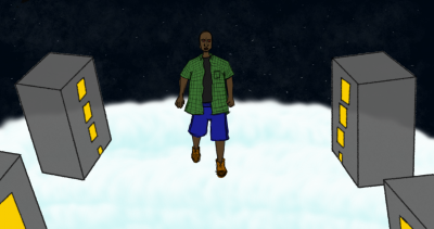

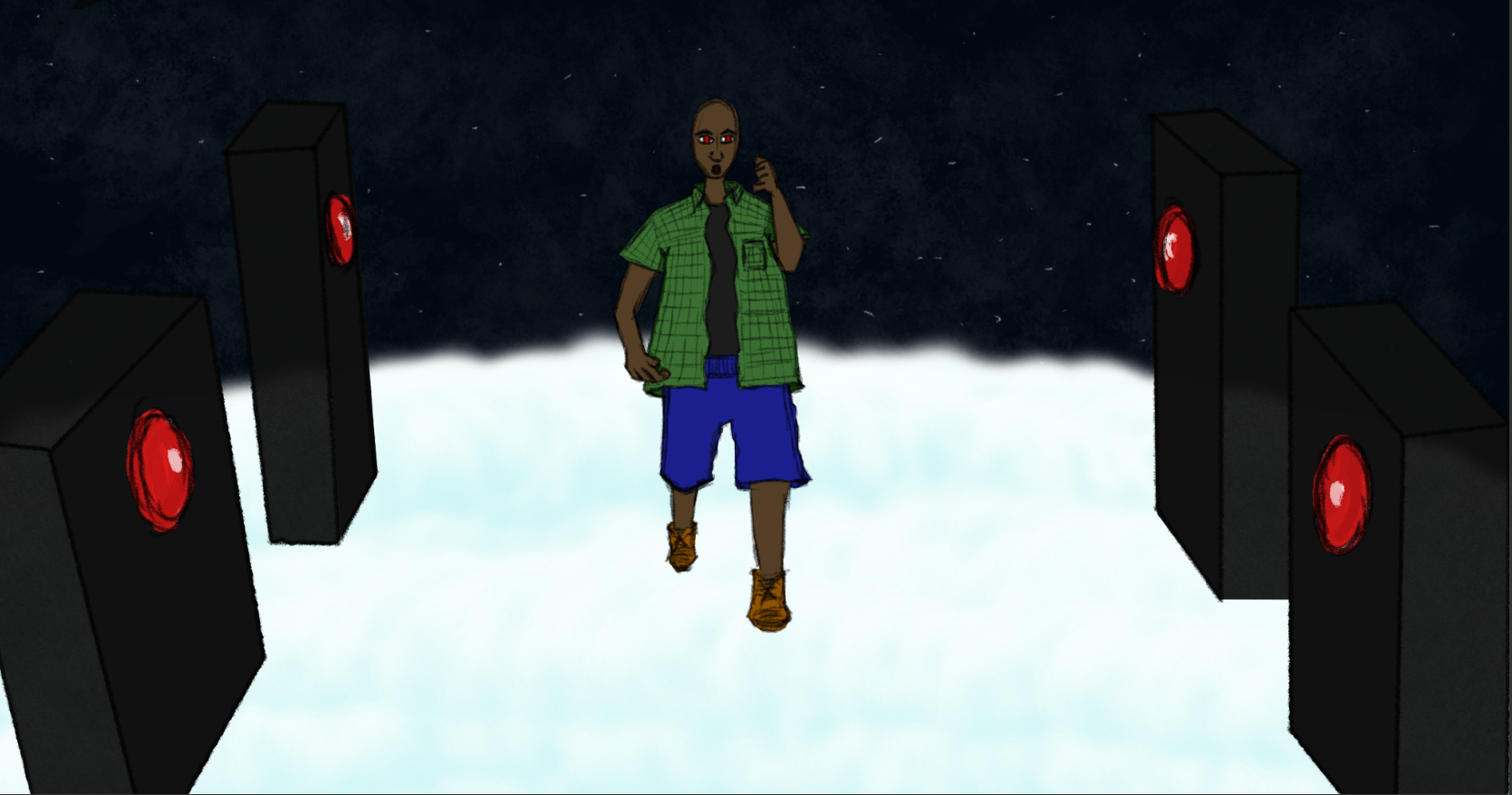

Hey guys, is anyone else having this issue when using the fill tool? The color seems faded and the BG is seen. I have to fill twice and in some cases this doesn't help too. I've attached a few screenshots here to describe what I mean, any suggestions on how I could fix this please? Do I have to have a plain white BG when coloring? If there's no layer underneath, tvpaint defaults to having a white screen anyways so I'm not really sure if having a white BG layer will help at all..

Have you checked if there's a paper active?

slowtiger wrote: 13 May 2024, 10:56 Have you checked if there's a paper active?
thanks for the reply slowtiger, i've checked and i'm pretty sure the paper wasn't active when i was filling color, will keep an eye out for it though, thank you for your suggestion :D

The possible reasons why any colour isn't 100% opaque are:
- the layer is not set to 100% opacity
- the tool is set to less than 100% opacity
- the tool is set to less than 100% power
- tool's power or opacity are pressure-dependent
- a paper is active
- a mask is active
- the layer is set to some other mode than colour
