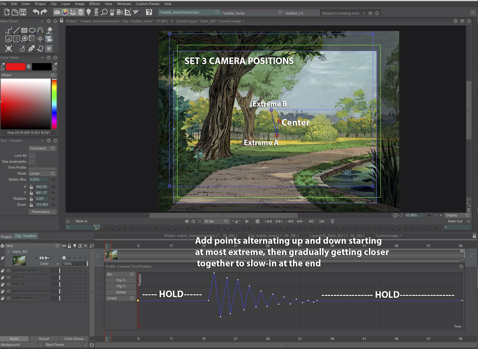

I think you can make it work with the Shaker FX (see Slowtiger's notes above), but it might just be better to do a "traditional" camera shake. Make the project overscale so you have some border around the edges to allow the camera to move beyond the normal border during the shake (so maybe over-scale by 120% - 200% depending on how violent the camera shake will be. If the scene is already created , you can Modify the Project to create a border , just make sure when you Modify Project you uncheck the box "Stretch To New Size" so it will keep the artwork the same size/proportion, but will add blank border area around the edges . Then you may need to extend the background and/or the characters a bit to account for the camera shake moving beyond the normal border.

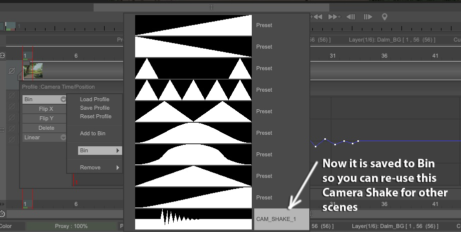

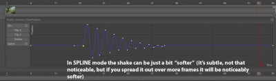

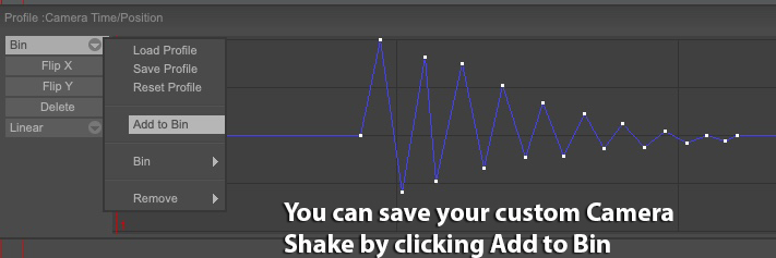

You can set the Camera Time Profile for a "shaking" effect. I will usually set three camera positions: CENTER and Extreme UP and Extreme DOWN. Play around with the number of points and the spacing on the curves on the Camera Time Profile to get the camera shake effect you want. Linear mode tends to give a harder/sharper shake while Spline mode will give a softer shake (especially if you spread out the points over more frames). Adjust the spacing on the points until it looks right to you. The camera tool is getting a major revamp for v.12 and this sort of thing should be even easier to do when v.12 comes out.
[click images to view larger]
The resulting camera shake using the Camera Tool:

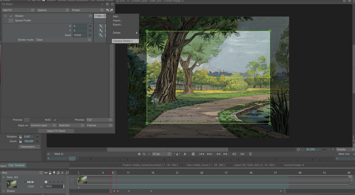

Here is a camera shake keyframed with the Shaker FX -
[click image to view larger]
The resulting camera shake using the Shaker FX:

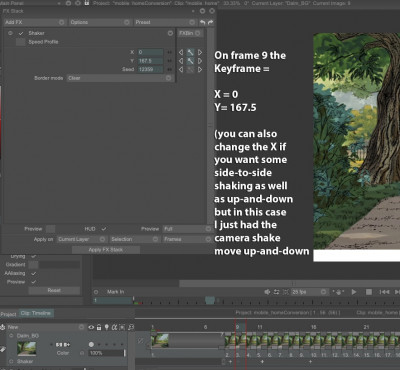

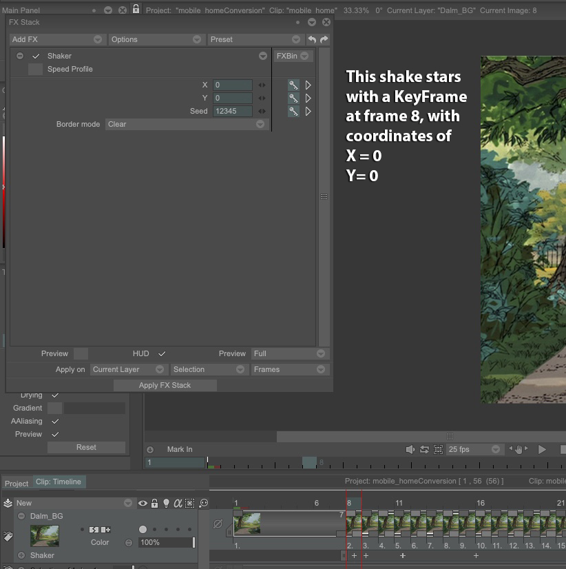

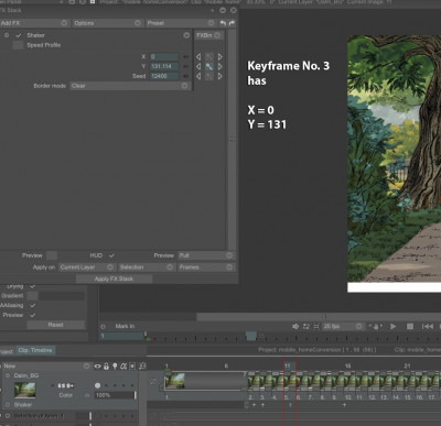

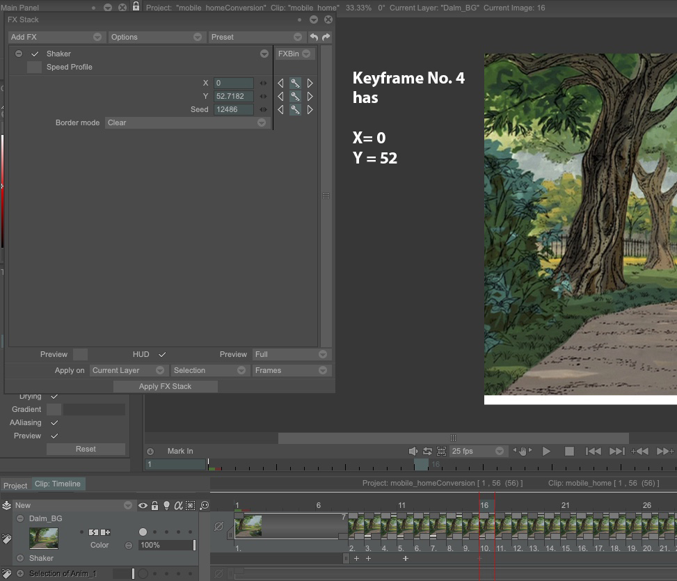

For the Shaker, here are the coordinates I used. I only changed the Y (North-South/Up-Down) coordinate, but if you want some East-West/side-to-side action you can change the X coordinate, too. Again, by playing around with the amount of "shake" on the X and Y (plus you can adjust the "Seed", although I don't really understand what that does!)
and sliding the keyframes up or down the Timeline , you can adjust the shake so you get it just right. I didn't spend much time on this one , so it's just a basic shake. Refining the position of the keyframes a bit can make the shaking taper off more or less gradually as needed.
X and Y start at 0 .
The most violent shaking is at the start on the first frame after the hold , with other keyframes clustered closer to the start , then the amount of shaking tapers off to the end.
X = 0 and Y = 0 at the end.
Screen Shot 2023-12-31 at 12.56.51 PM.jpg (64.47 KiB) Viewed 6893 times
[click on any of the images to see them larger]
Shaker_Keyframe_No_5_returns to 0.jpg (87.1 KiB) Viewed 6893 times

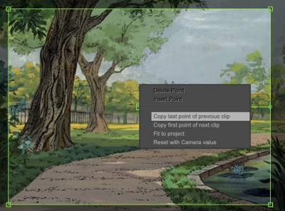

Something to remember when splitting a scene into multiple clips and then adding customized camera moves to each clip is that when you move on to the next clip you can click on the middle point in the camera field and select "Copy Last Point from Previous Clip" from the menu , which means that your starting camera position in the current clip will be exactly the same as the end camera position of the previous clip, so the camera positions will be consistent from the end of one clip to the start of the next clip.
