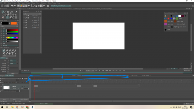

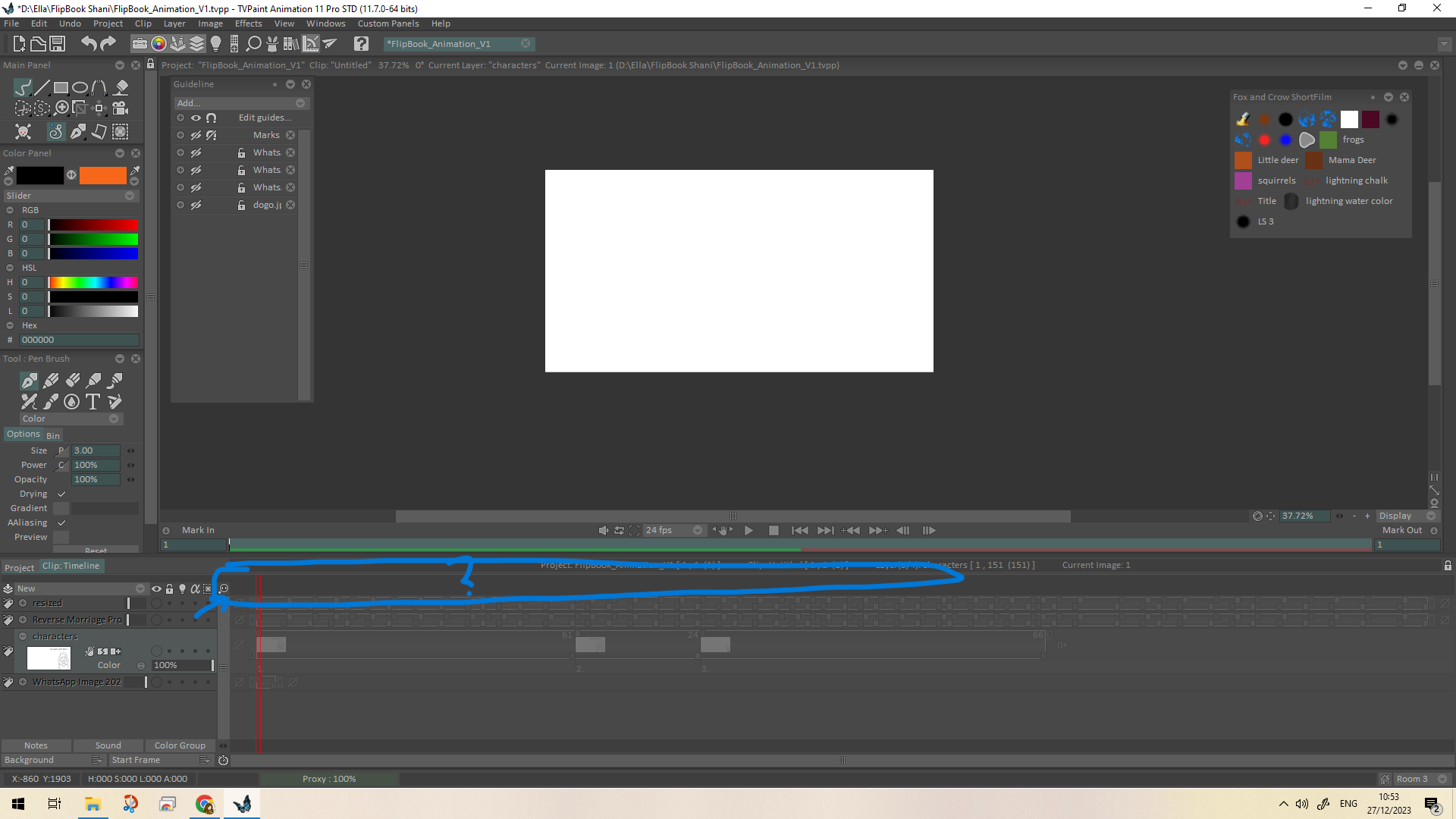

Hi I encountered a weird bag that I couldn't find a solution to it yet (It's over two months now and I just got used to working with it).
The frame numbers above the timeline has disappeared, and they come back once in a while for no reason and disappear again. ^^"
What I tried so far that didn't work:
1. Changing to time code instead of numbers and back.
2. opening new project windows
3. opening\closing the program
4. restart the computer
5. reinstalling the program
If anyone has any idea what can solve this I'll be happy to have my timeline numbers back. ;v;
Thanks.

Hello, I noticed that you are using TVPaint v11.7.1, I would recommend updating to the latest version after making backups of your custom brushes and keyboard shortcuts:
https://www.tvpaint.com/doc/tvp11/index ... m-settings

The Frames are back! yay!
Thanks Dean
