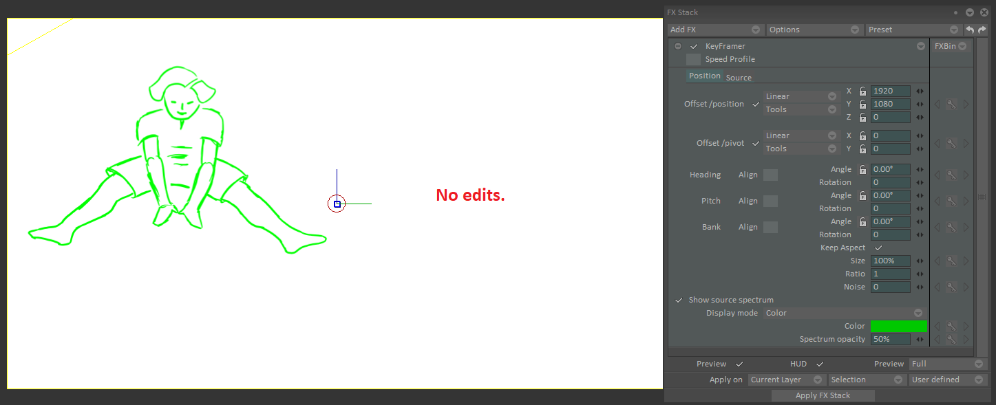

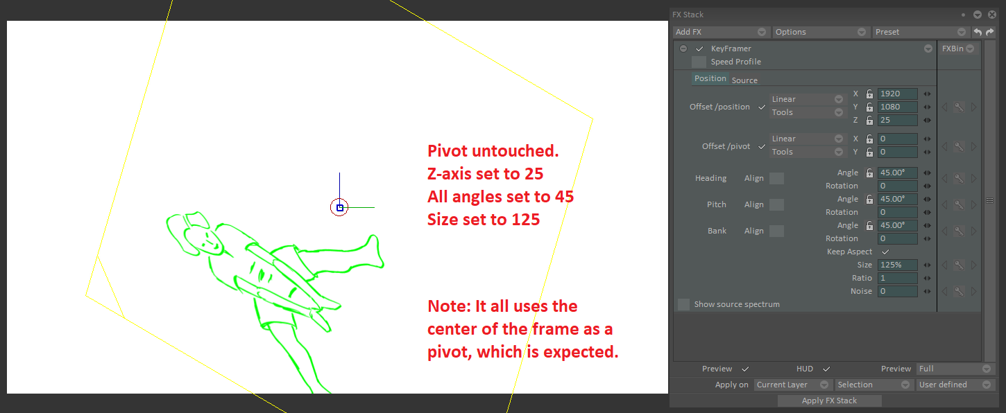

After the latest update I noticed that you can now click and drag the pivot point to the place you want to, instead of having to manually change the values of the pivot, and then substracting the values to the position values (or using the custom brush method)

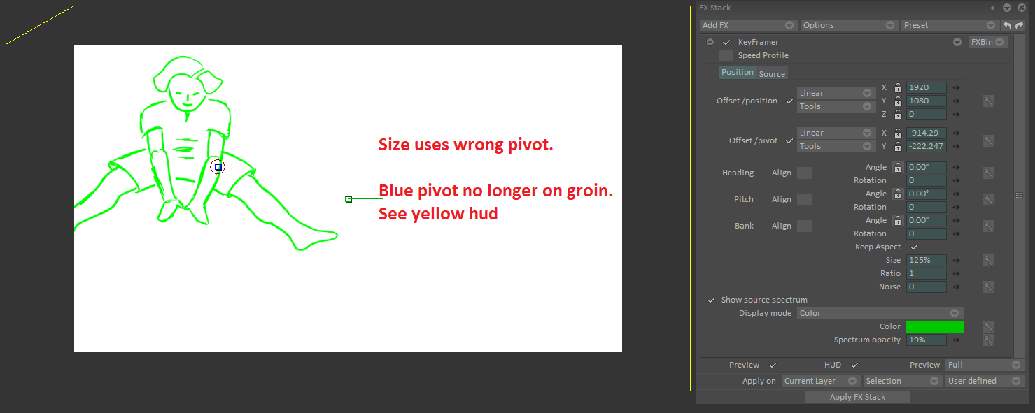

While this is a very welcome change, it doesn't work properly yet. Mainly with the Size and the Z-axis position parameter, which still seems to use the centre of the frame as a pivot point. Because of the changes, it now also impossible to move the pivot to a place you want to, as the movable pivot seems to only work for rotations. I have added a bug tag to this post, because I can't imagine this is intended behavior. I have also added screenshots for your convenience and clarity.
Does anyone have a workaround? And is this in the roadmap for getting fixed?

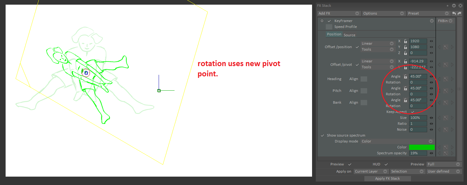

I can confirm this,
for rotation and position the keyframer does use the offset pivot coordinates,
but when you scale, it does so from the original position coordinates, which is not intuitive/desired.

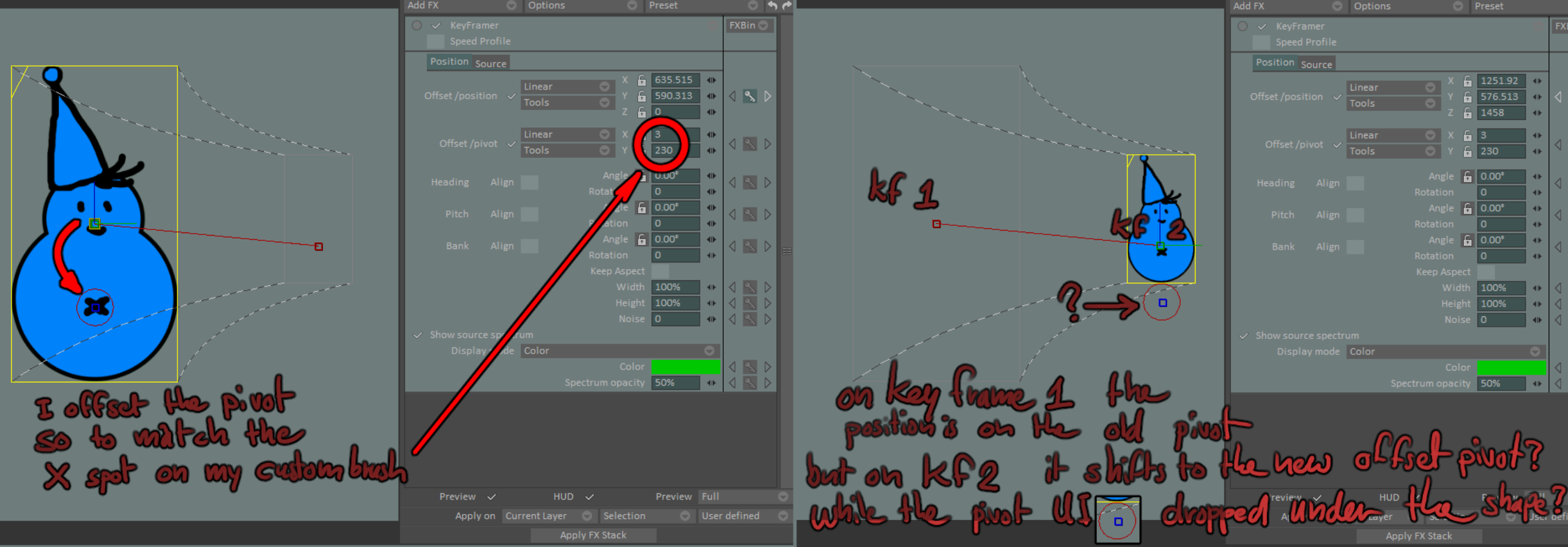

ran into it again today...
the new pivot is not yet functioning correctly
see explanation in image.
