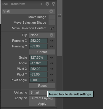

I think it would definitely be useful to have the Reset All option listed in the right-click menu for Transform Tool (as in Perspective Tool), but there is a Reset button in the tool panel that doesn't require 3 clicks to reset Scale, Position, Angle. Leo, I'm glad you mentioned the shortcut of ESC to reset positions of Scale, Position, and Angle. I did not know about using ESC for that purpose , but it makes sense now that you mention it

D.T. Nethery wrote: 21 Sep 2023, 14:20 I think it would definitely be useful to have the Reset All option listed in the right-click menu for Transform Tool (as in Perspective Tool), but there is a Reset button in the tool panel that doesn't require 3 clicks to reset Scale, Position, Angle. Leo, I'm glad you mentioned the shortcut of ESC to reset positions of Scale, Position, and Angle. I did not know about using ESC for that purpose , but it makes sense now that you mention it
I know, but this panel sometimes gets scrolled up or down and it takes another click to scroll it to be visible, and then find the button I need. It takes more time than ESC or just right click wherever my hand with pen is...

Yes, for sure ! It should definitely be added to the right-click pop up menu for Transform Tool options.
