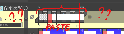

i have the same issue.
when i copy a selection from one project to another the first frame is left empty while the duration of that first instance is taken from the selection length of the first instance of the copied frame
and also still encounter the bug where tvpaint does not display framenumbers nor timecode...
