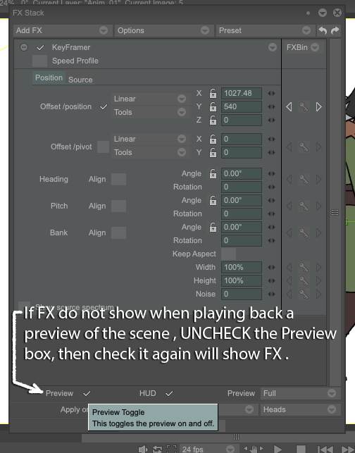

I notice this issue still happening in 11.7.2 .
In previous versions of TVPaint when using KeyFramer FX and pressing play, TVPaint would playback a preview of the scene with the FX.
Since 11.7 to 11.7.1 to 11.7.2 when the user presses play it does not playback a preview of the FX , unless the user first unchecks the box "Preview" at the bottom left of the FX Stack panel, then checks the "Preview" box again. After doing that it will playback a preview of the FX. So the workaround is easy (although in the previous post Soom mentions it does not work for him), but this still seems like a bug that should be fixed.

This is still occurring in the current version, v12.0.1 albeit with a slight difference from the above post. The fx preview will work on the FIRST playback after you press play without having to uncheck/recheck the "Preview" box, but if you stop and try to play it again you need to uncheck/recheck the box.D.T. Nethery wrote: ↑14 Dec 2023, 12:33 I notice this issue still happening in 11.7.2 .
Tvpaint 12.0.1 Pro
Tvpaint 12.0.1 Pro
