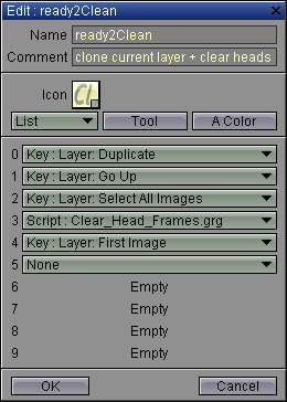

that's nice, ... and quickly served ! 8)
thanks Hisko for this request, and thanks Hervé for the script, it works like a charm ... :D
Icon.zip
(2.52 KiB) Downloaded 1188 times
