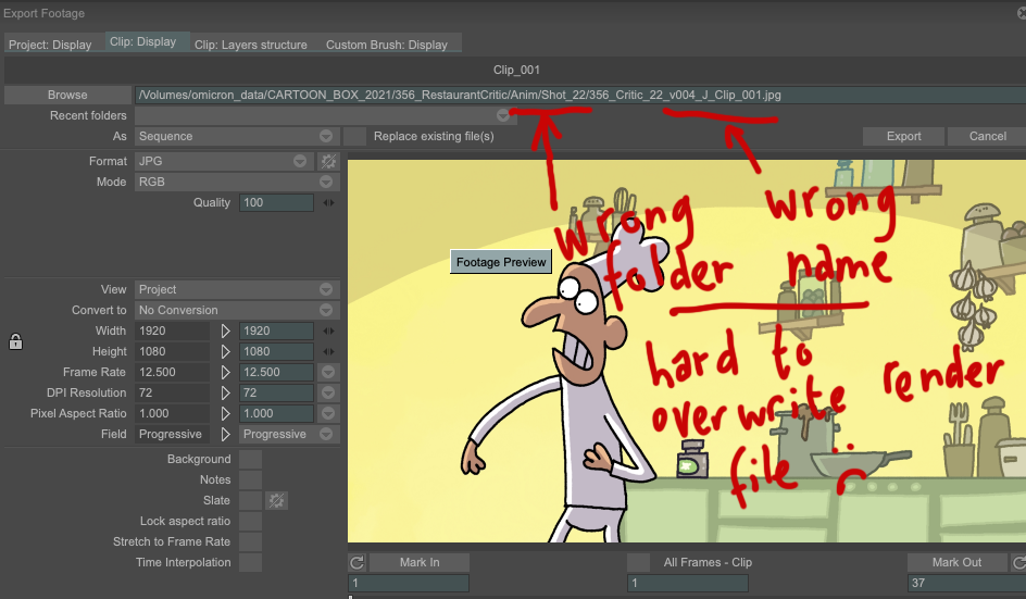

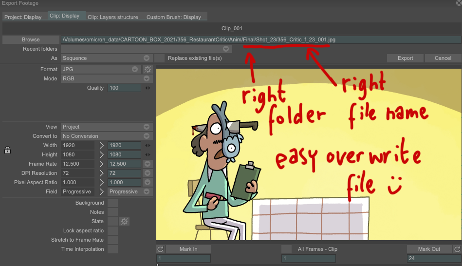

So I opened three files that my intern has worked on yesterday.
Two of them keep the render path I used the last time. (In my render/finals folder), the other one suggests to render it in the same folder as the project is.
Al three files have been rendered before. And I want to overwrite the rendered files.
Why does it choose a different path and name with this one file?

hmmm, and now I had the same issue with a file that has only been opened on my own computer.
I tried to export it, and the export path plus file name were changed all of a sudden. What makes TVPaint change the path sometimes, and sometimes not?...
This is really strange to me.
