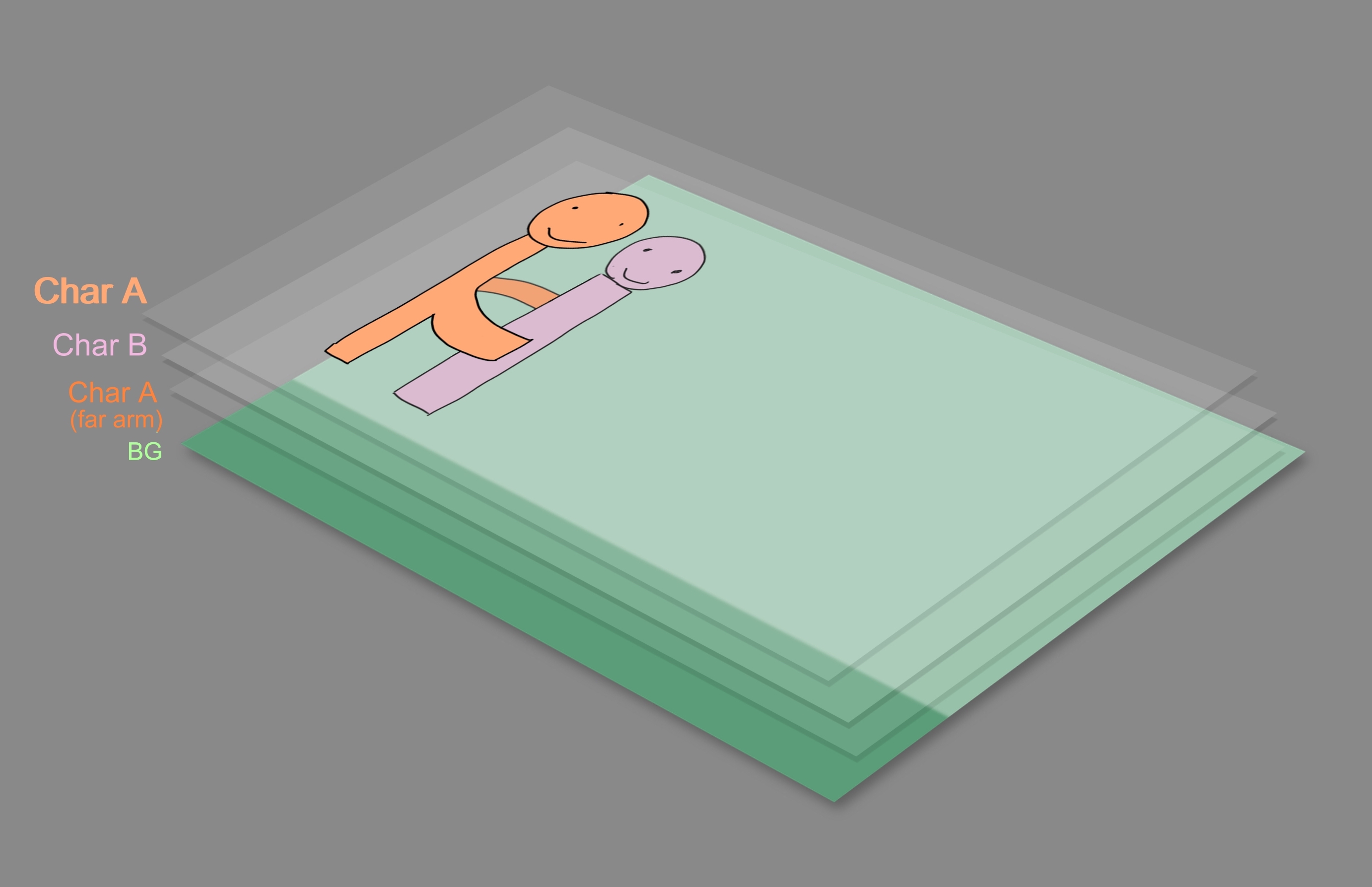

it_ross wrote: ↑28 May 2023, 19:54 The particular reason why I'm trying to figure this out is because I'm trying to make two animated layers overlap with one another, such that part of layer A is IN FRONT OF layer B, while another part of layer A is BEHIND layer B. An example of this would be two characters on two separate layers hugging, for which I drew an extremely simplified example:
The character on the left has one arm in the foreground and another arm in the background. If these characters are on separate layers, I would like to know how to keep the left character on the top layer, while having the character on the right obscure the background arm, if that makes sense. I figure that masking, as described above, would be the answer.
Thank you.
Draw Character A on the top layer over Character B. This top layer includes Character A's foreground arm that goes in front of Character B.
Draw Character A's far arm on a layer underneath Character B.
Background layer is underneath all.
Layer 1 - Character A (including foreground arm)
Layer 2 Character B
Layer 3 - Character A's far arm (behind Char. B)
Layer 4 - Background

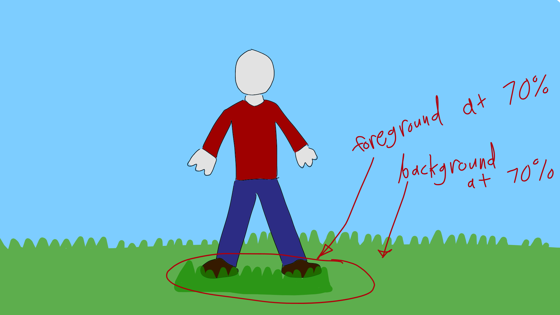

The bush may have been a poor example. A better example is if the character is standing on grass and I want to have some of the grass be in front of the character. If the background layer is not at full opacity, then whatever overlay I use for the grass won't match it. Even if I set the overlay's opacity to match the background, you'd be able to see the character's feet through the grass: As for the characters hugging, the method you describe works for when there is a clear border separating the left character's body from the rear arm, but I'm not sure how to implement this solution if there is no such border in the design:D.T. Nethery wrote: ↑29 May 2023, 15:04 I'm not sure why the background not being at full opacity would have any effect on the bush overlay ?

it_ross wrote: ↑29 May 2023, 20:54 Thank you for the response.
The bush may have been a poor example. A better example is if the character is standing on grass and I want to have some of the grass be in front of the character. If the background layer is not at full opacity, then whatever overlay I use for the grass won't match it.D.T. Nethery wrote: ↑29 May 2023, 15:04 I'm not sure why the background not being at full opacity would have any effect on the bush overlay ?
If your intention is to have the grass and sky be a lighter color, why not just paint the background with the lighter colors at 100% opacity to begin with , rather than paint it darker and then lower the opacity to make the background colors appear lighter ? Then the grass overlay around the character's feet could be the exact same green as the grass on the background.

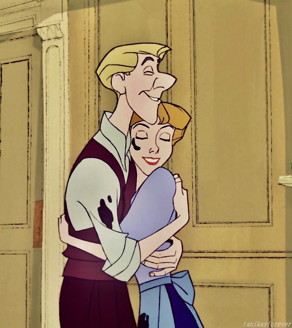

In the situation you describe here with two characters touching, how would masking as in Photoshop solve the problem of the overlapping parts ? (to be clear: I'm not disagreeing with you or saying that masking a la Photoshop wouldn't be useful, but I genuinely don't understand what you're envisioning in terms of using masking in this case, so I'm trying to understand what result you would like to achieve.) It seems to me that it would be easier to draw both characters together on the same layer.
To use a more complex example, if you had a scene with two characters in close contact like this , with different parts of their bodies touching and overlapping , it would be unnecessarily complicated to split up the different ovelapping areas as separate layers.
