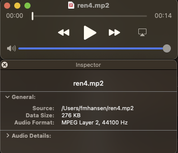

Attached are screenshots of the 4 audio files I tried using. Each one had a crackle/pop in TVP timeline playback. Although this issue started a while ago not sure what started it. Could have been my upgrade to 11.7.1
