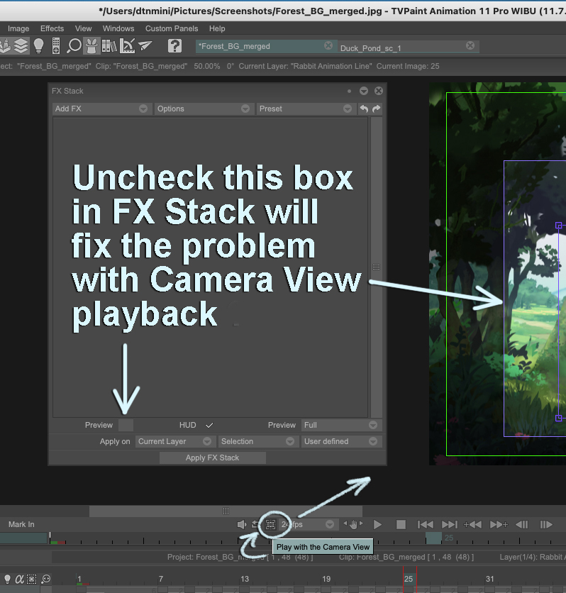

I really meant the FX stack, we have recently found that this thing is linked to the camera view playback issue (it was mentioned on another thread, I think).
Posts: 4272
Re: TVP cannot show the Camera preview and Force proxy render
Dean wrote: 14 Apr 2023, 14:21 I really meant the FX stack, we have recently found that this thing is linked to the camera view playback issue (it was mentioned on another thread, I think).
Ok.
And now I've had time to test it. Yes, uncheck the box next to Preview in the FX Stack to fix Camera View playback issue ! Very interesting.
I would never have guessed that the FX Stack Preview had anything to do with the Camera tool. How did you ever discover the connection ?
Apparently you only have to uncheck the Preview box in FX Stack one time , because I noticed when the FX Stack is closed and reopened the Preview is checked again,
but unchecking it one time fixed the problem with the Camera View playback.

Just had this bug and can confirm that unchecking the preview from the fx stack worked. Appreciate the feedback as on any normal day this would have stumped me to try figure out, thanks!

I've been suffering from this problem all day, but thanks to you, I solved it.
When the preview was activated in the fx stack, not only the camera problem but also the 'play from current frame' function operated abnormally.
