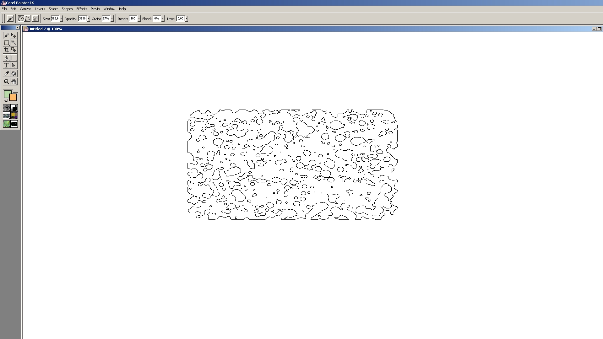

Peter (Tantalus) and I made a screenshot of the painter-brush, and imported the image in TVPaint and added paper and pressure for the opacity.
I'm working with the brush right now and it feels even better than the one in Painter.
I attached the screenshot.
