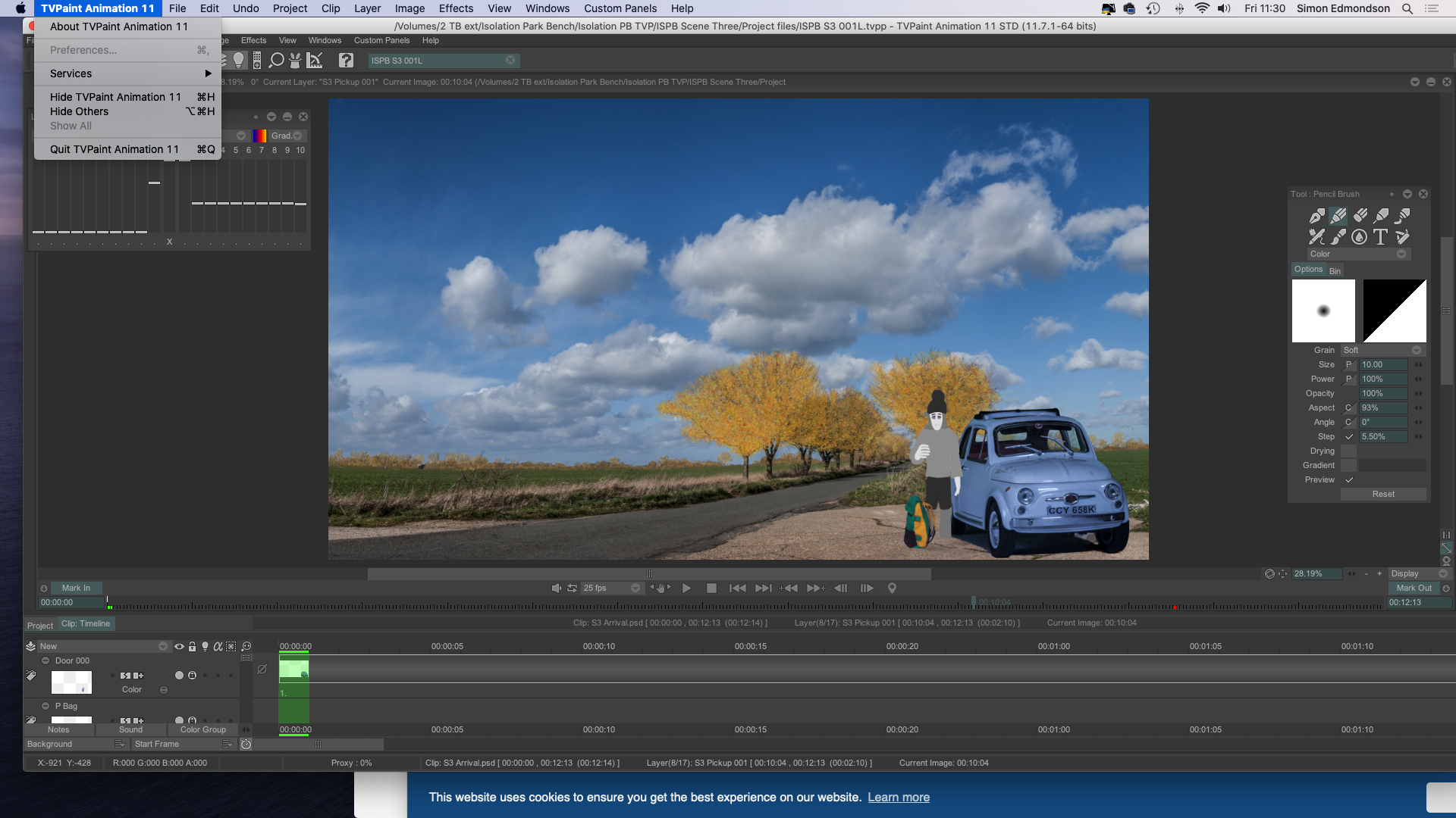

Hello Simon, do you mean that your Preferences menu in TVPaint has some options greyed out?
Could you maybe post a screenshot of this, please?

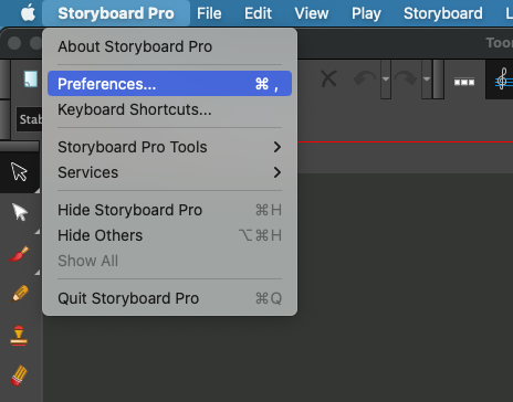

Simon W Edmondson
Posts: 46
Joined: 25 Jun 2020, 12:14
Re: Loading problem
Post by Simon W Edmondson »
Thank you for your reply.
Its not just options within the preferences tab that are greyed out, but the whole preferences option under the menu.
regards
simon
Posts: 4272
Re: Loading problem
Simon W Edmondson wrote: 19 May 2023, 10:35 Dean
regards
simon

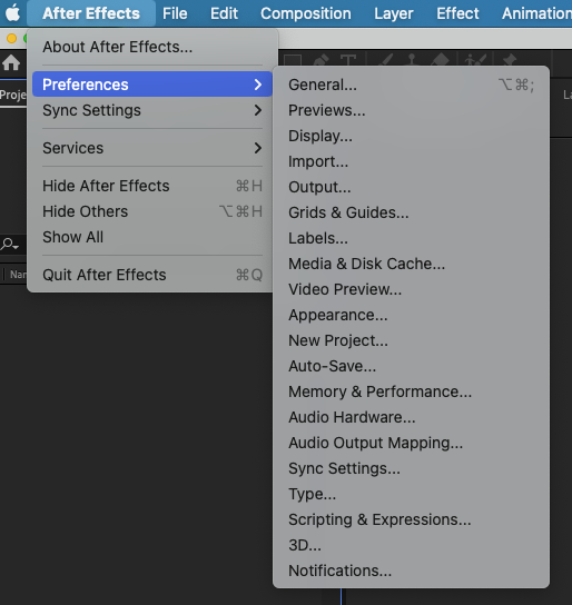

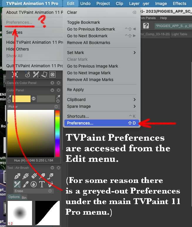

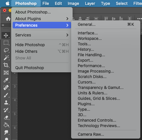

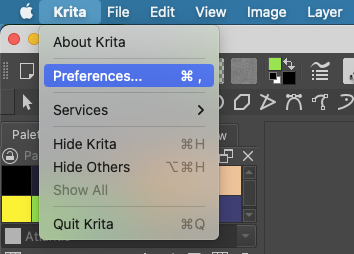

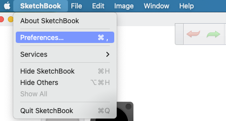

It is strange and confusing that there is a greyed-out 'Preferences' under the main TVPaint Animation menu , but the actual Preferences are accessed from the Edit menu.
So why are TVPaint Preferences confusingly located under the Edit menu instead of in the usual place to access Preferences as in all other drawing and animation programs ? This has always been a mystery to me.

I agree that its behavior should be made redundant with the Edit menu's Preferences item, I just added it to the to-do list.
