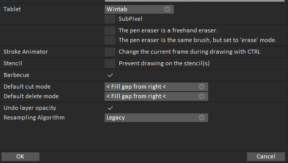

Color is not consistent when after using eraser, I don't know if anyone can recreate this consistently so here is a video showing the issue.
11.7.0 oct 6 hotfix
My eraser settings.
With more testing, this happens with all eraser settings in preferences

TVPUSER wrote: 10 Oct 2022, 05:42 Color is not consistent when after using eraser, I don't know if anyone can recreate this consistently so here is a video showing the issue.
11.7.0 oct 6 hotfix
My eraser settings.
This could not be reproduced here.
However I notice that you have both the eraser checkboxes unchecked in your settings, which means you have regular tools on both ends of your pen. We'd need to know which tool you have on the eraser.
Could you please also try resetting your Wacom settings ?

I've gone through all permutations of the checkboxes and this still happens every now and then. I've done what I can to reset my wacom settings also.. It still happens though getting it to reproduce 100% of the time is still something I haven't really figured out either.. it is still quite annoying..

Hi, does this only happen with the color panel in "Slider" mode?
It almost seems that TVPaint detects your stylus as 2 different ones with different tools memorized at each end, so weird!
