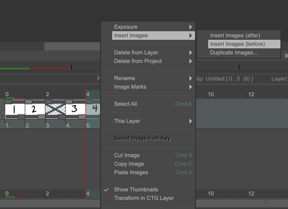

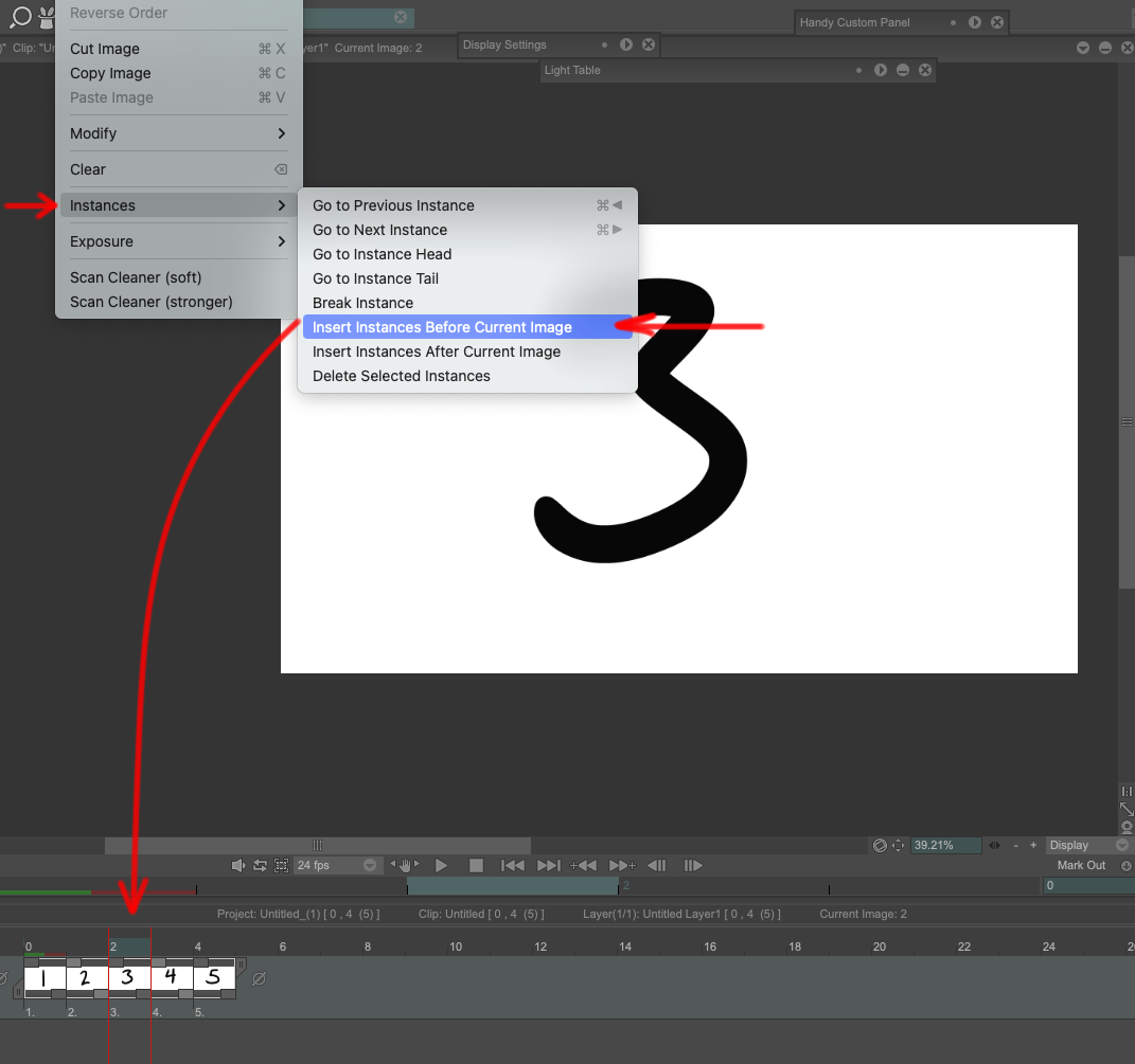

For adding a new blank instance before the current instance use Image menu > Instances > Insert Instance Before Current Image. This can be assigned to a short cut key.
Or right-click on the layer and from the menu select Insert Images before.
Screen Shot 2022-10-04 at 9.29.43 AM.png (38.59 KiB) Viewed 2115 times

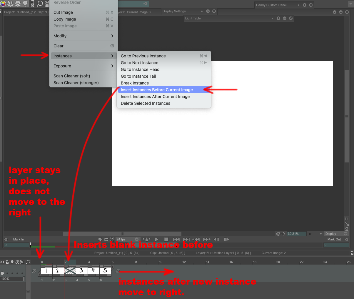

You can assign this shortcut to any available key -
Screen Shot 2022-10-04 at 9.16.32 AM.png (12.51 KiB) Viewed 2116 times
