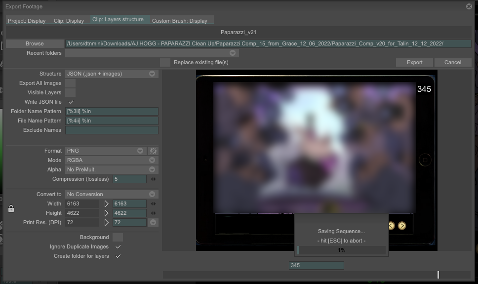

I've been having this problem for a while now. Tried to solve it by updating TVPaint, but the behaviour is still the same. This is my process:
1.
I Export structure of my project using JSON from TVPaint (v 11.5.3 - 64 bits):
This is the original visual:
This is my export settings:
2.

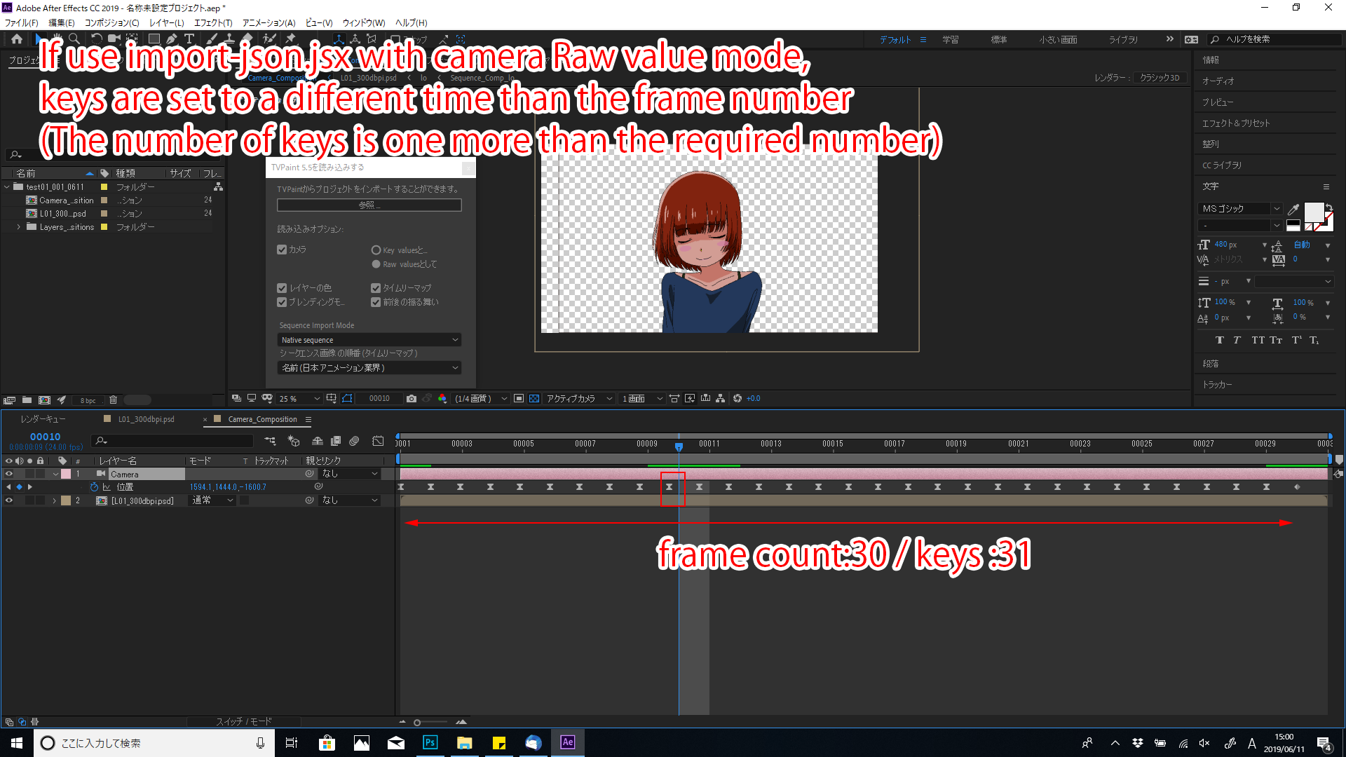

Previously, I pointed out the following to the development members.
・The number of keyframes increases by one when exporting in Raw value mode
It has not been resolved.
I think the reason for your question is that you are using an export method that assumes a Native Sequence instead of an Index, as you have answered in the past.

Now I noticed another problem with the option Ignore Duplicate Images. It makes sense to me to avoid exporting duplicate images, to cut down on the file size , but it seems to cause trouble.
Today I exported a scene where I had checked Ignore Duplicate Images. When I imported it into After Effects only about half of my layers were exported to AE (I double-checked to see that all the layers are in the folder with the JSON file ... all layers are there in the folder, but for some reason many of the layers don't get imported to AE).
What is the purpose of the option Ignore Duplicate Images if checking that option won't allow the scene to be imported correctly into AE,with the proper timing or with all the layers included ?
In the user guide about Ignore Duplicate Images it only says: " select this option when you don’t want duplicated images to be exported." But there should be some sort of warning that choosing this option may cause the scene to not be imported properly into AE.

Here are my settings for export to JSON:
UPDATE: I believe this is definitely a bug in 11.7 (haven't tried 11.7.1 yet). I went back to version 11.5.3 to export to JSON, then used the script to import to After Effects . It worked as expected. Because this is an older topic that already has the green check-mark ("solved") applied, I am going to start a new topic about this issue in TVPaint 11.7.

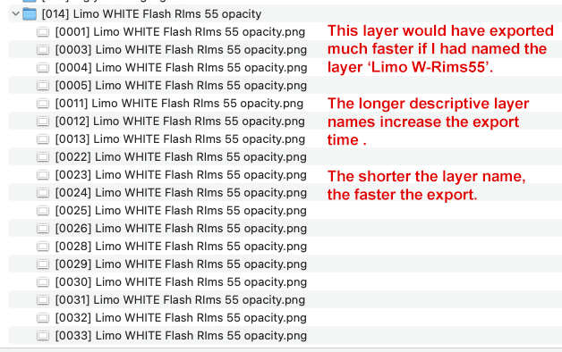

Unrelated to the issue of using % symbol in layer names, but related to exporting to JSON file in general: something else I have learned is that the length of layer names has an effect on how long it takes to export a scene to JSON file with all the PNG sequences separated in individual folders. The shorter the layer name, the faster the export. Longer layer names increase the time it takes to export. This should have been something I understood intuitively because it is logical that the more data the computer has to process and write to the file, the longer it takes. But I didn't notice it until recently because on some of the scenes I've been working with recently I included some "descriptive" info as part of a layer name, such as: 'Paul's Shadow on TOP of car roof 24' (the 24 referring to the layer opacity of 24% , so the shadow is transparent on top of the car roof) Because by default JSON layer structure assigns the name of the layer to each PNG image exported, a lengthy descriptive layer name like 'Paul's Shadow on TOP of car roof 24' increases the time it takes to export each image. Better if I had named the layer 'Paul Shad Top 24' or 'PShad Top 24' or 'PShad24'.
Screen Shot 2022-12-22 at 10.43.29 AM.png (70.1 KiB) Viewed 8270 times
The fastest way is to name layers simply with an A, B, C, D, E, F, G ... system , so a layer may simply be named 'A' , or a 1, 2, 3, 4, 5, 6, 7 ... system so a layer name is just '1' or at most '1-A' .
I believe that the JSON naming structure can also be adjusted to not include the full layer name , but in my laziness I have left it set to the default naming structure which includes the full layer name appended to each image.
