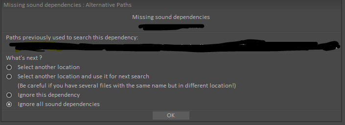

I'm scripting an export of a tvpp files as PNG, and for a tvvp file, I have a
missing sound dependences popup window cf. attachement.
How can I get rid of it in my script?
I'm using "tv_LoadProject silent 1" for now.
Thanks in advance !

Actually no, if you saw the popup as you explained then I'd think the silent parameter wasn't used.

The Tvpaint with "tv_LoadProject C:\Myprojectpath\mytpv.tvpp silent 1" hangs as you say (freeze at 90%) with the file which miss the sound file (bar.tvpp).
The script send to os.system:
Code: Select all
C:\"Program Files\TVPaint Developpement\TVPaint Animation 11.5 Pro (64bits)\TVPaint Animation 11.5 Pro (64bits).exe" "cmd=tv_LoadProject C:\Users\foo\Documents\bar.tvpp silent 1" "cmd=tv_SaveMode PNG b32" "cmd=tv_Background NONE" "cmd=tv_AlphaSaveMode NoPreMultiply" "cmd=tv_SaveSequence C:\Users\foo\Documents\bar_001.PNG" "cmd=tv_quit"
I'm on the version 11.5.3-64 [1359wo]
Too bad I came across the bug!

The bug may occur on every project file with missing dependencies (ie: video that was not preloaded, or sound).
So yes, you can try to open the project in TVPaint : provided you don't click on "ignore all dependencies", TVPaint won't freeze.
Regarding the audio files, you can remove the ones that are missing (or all) using the sound panel.
Regarding the missing non-preloaded videos (if any), you will have to provide an other location I guess... I know no option to remove the references from TVPaint.

Ok, but there is a certain chicken and egg question here.
As I cannot open with a batch script the files with a missing sound file, while the popup hang the process while opening them.
As I want to open a list of tvpp files, export still png from them. The script either show the "missing sound dependencies" popup, and the script hangs here, or if I set the "silent 1" it also hangs.
So I cannot unlink the soud with the Georges script, as I cannot open open the file first.
The idea of removing the sound file with a script is not working here!
I'm stuck with with "silent 1" bug, and don't see another alternative here, another idea? Wait for the next release!!?
