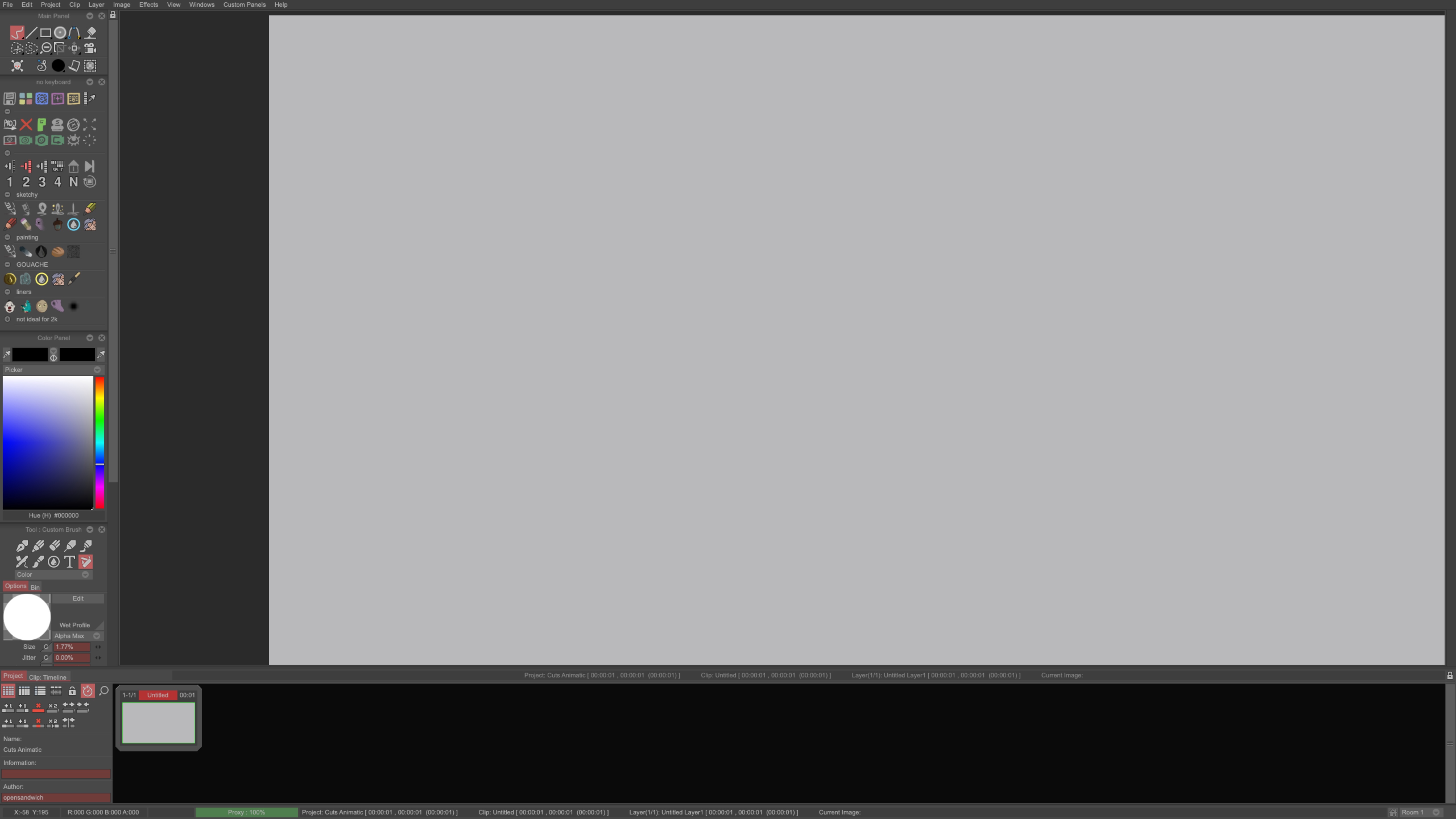

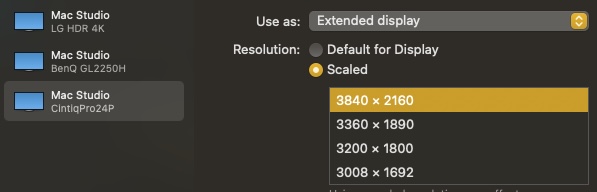

The Lag i've been having outside of the one that comes up with sleep / wake etc. seems to be more on the line of resolution scaling. I.e. when using a true 4k scaling, the interface looks like this (and lags a lot)
Screenshot 2022-07-21 at 09.51.11.jpg (27 KiB) Viewed 5508 times

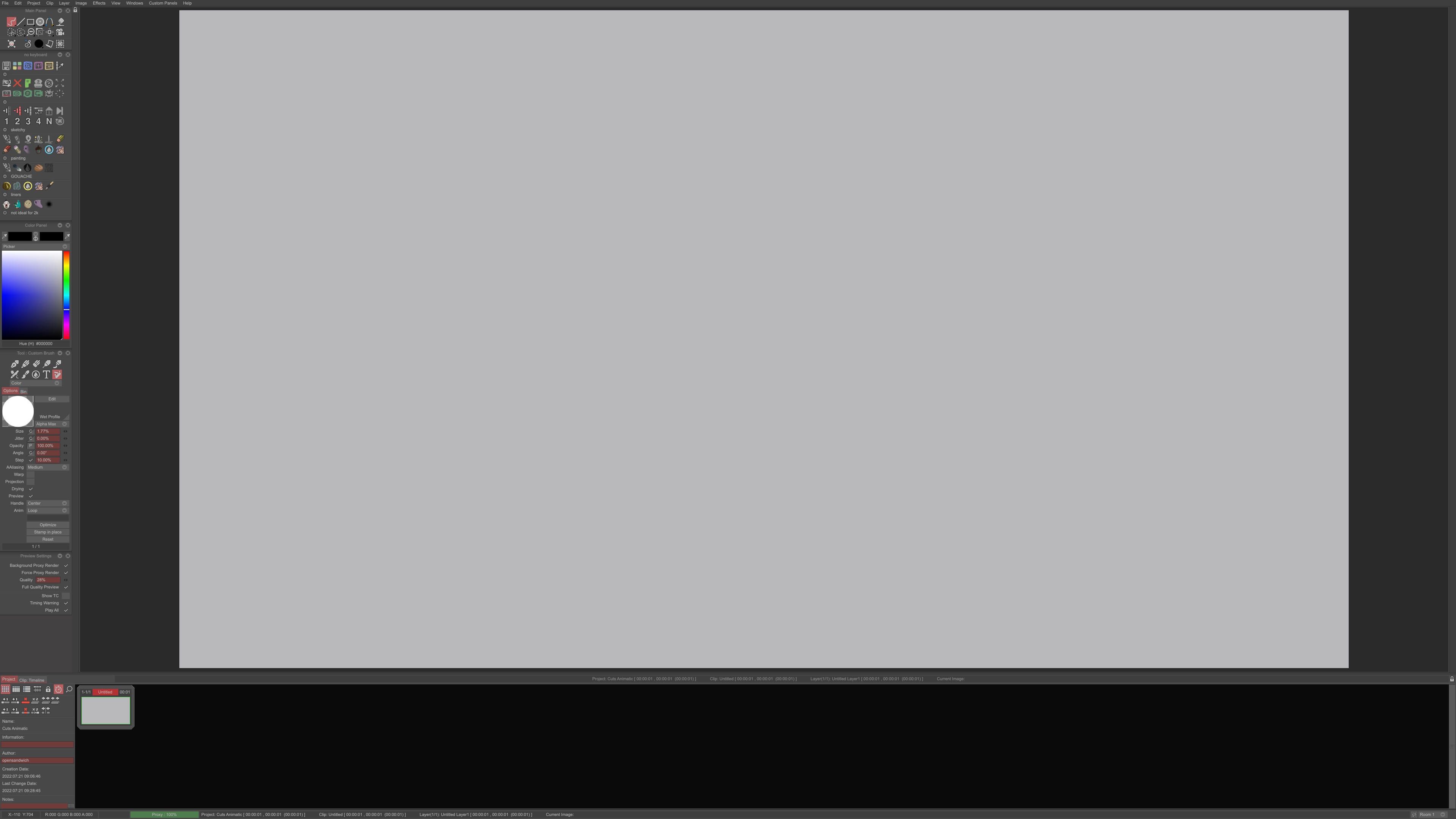

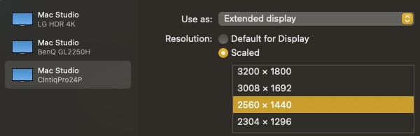

and setting the resolution scaling to 2k (which makes the interface proportionally bigger) is when those lag issues are pretty much un-noticeable:
Screenshot 2022-07-21 at 09.55.14.jpg (27.7 KiB) Viewed 5508 times
But yeah the main issue with this is that everything on-screen is 2x more blurry making it more preferable to draw in other programs that handle 4k perfectly fine like clip studio or photoshop, there's less space on the screen, and it's a hassle changing the screen resolution every time the program is opened.
