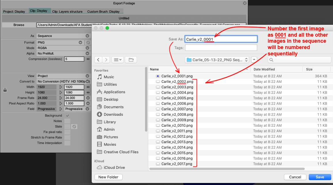

The same as Slowtiger mentions in the post above, I find that the current file numbering structure works like this: If I am exporting a PNG image sequence (or TGA, TIFF, JPG, etc.) I only need to name the first one in the sequence as XXXX_XX_0001.png , and when I click Export all the other images will be numbered sequentially as XXXX_XX_0002.png , XXXX_XX_0003.png , XXXX_XX_0004.png , XXXX_XX_0005.png , XXXX_XX_0006.png , etc.
Or did you mean something else about the naming/numbering structure ?

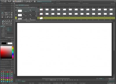

Thanks, Dean, that sounds familiar and I know I have seen it before! But on my current timeline there is only a lock/unlock option, not the arrow, rectangle and X options. This is on both my mac and PC using different licenses. Do I have something set weird?

Trying to insert an image into this post, I'll try both ways:
