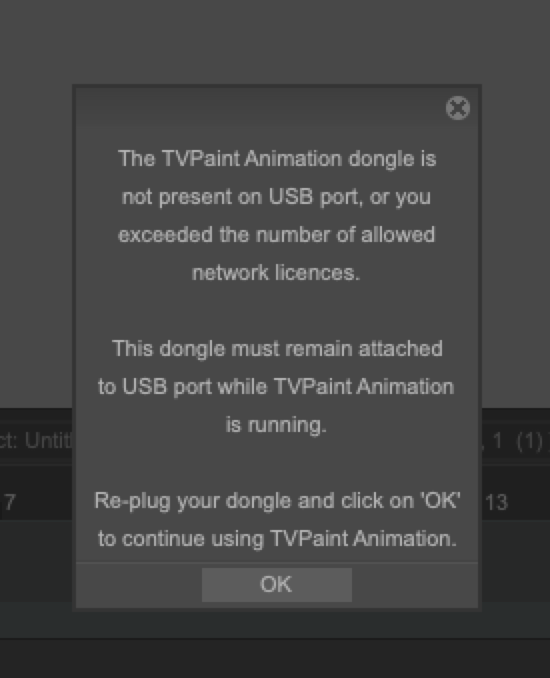

I have this problem with my new MacBook and can't run TVPaint on it, I install the newest version with its drive, I'm not sure if the problem is Big Sur or the the m1 MacBook.
here are my specifications attached with dongle issue,
hope someone can help soon,
thanks

Hi Riyart,
The old dongles no longer work with macOS Big Sur and higher.
Please use our Contact Form so our team can help you migrate to the new dongleless system

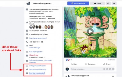

Speaking of the Facebook page , did anyone notice that all of these links to TVPaint's Instagram, Twitter, and YouTube are DEAD LINKS ? -
