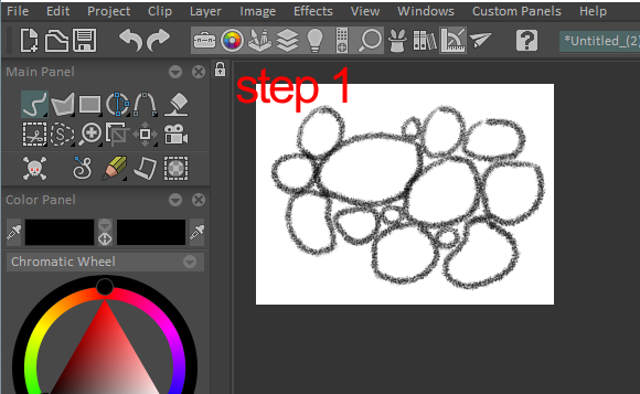

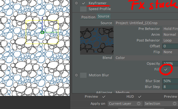

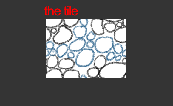

An easy way to create a "tile-able" pattern is by creating a project with the desired tile dimensions and use the panningtool set in "fill" mode.
you draw your pattern in two sessions... first the center... then use the pan tool to pan that first part from the center of the project to one of the corners.
now you can finish the [attern and you have a seamless tile, which you can place with the keyframer in the fxstack for instance.

Ha! Thanks Peter for those screenshots. I was aware of how to make a tile-able pattern but I had overlooked the fill checkbox in the Keyframer! I had always used the multilane camera for tiling because there was a pull down menu that was obviously for tiling but there was no way to control the angle of of the image on all the axis. Keyframer has these options but I didn't realize you could tile with it but it is right there, the fill checkbox! Magic! This is so incredibly useful to me right now thank you.
Maybe that is something for future releases to have both these options in the Multiplane camera and the Keyframer to be named the same for clarity.
