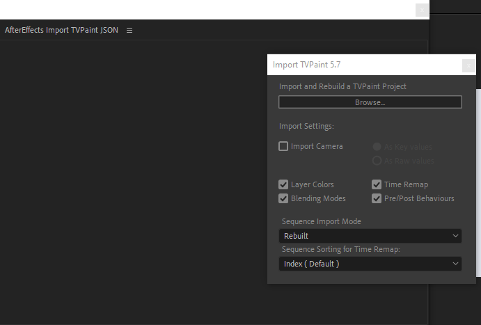

I have issues with importing my exported animation to After Effects 2022. Here is what the script looks like when booted up
After clicking on "browse" and selecting my .json, nothing happens. It was working fine with AE 2021.
Can anyone confirm this is happening to them as well ?
Thank you

reset workspace to standart and try again

Ah yes it works while selecting the workspace to standard. I thought the "default" workspace was the one that worked. Thank you!
Don't know if this helps, I managed to still import my animation using DuIO from Rainbox Labs.
