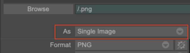

I can see that you are not using the "Single Image" option:
Could you please try select it and try to export your single frame again? It should work as expected.

Those Mark In and Mark Out points were designed to work with Sequences only, hence why it's ignoring your single selection.
We may be able to try implementing an automatic switch to the Single Image setting when a singe frame has been selected
