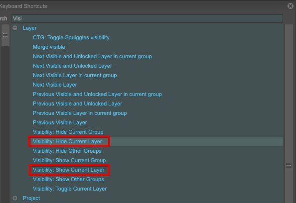

Hi Joost,
Regarding invisible/inactive layers, those two shortcuts may already allow you to (partly) achieve what you want :-)
Joost
Posts: 439
Joined: 24 Nov 2011, 13:16
Re: disable preserve transparency
Post by Joost »
Thanks! I was one update behind. Gonna download it immediately.
I'm really happy with this one. 😀
